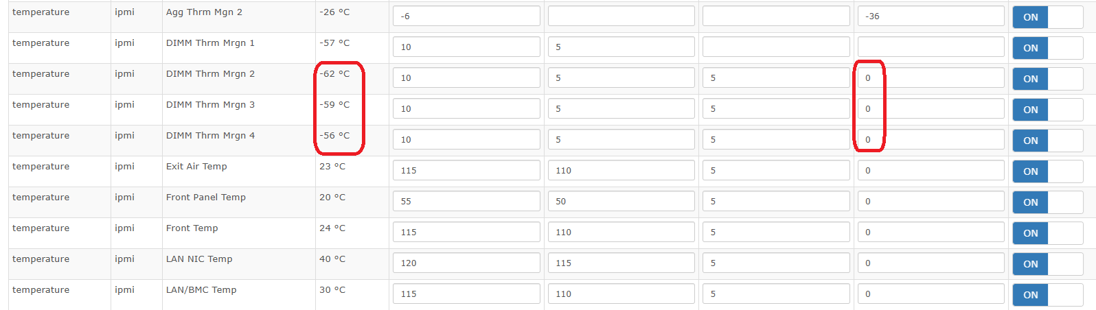

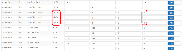

Our system auto updated to 26.4.0 and lots of my sensor thresholds are wrong again causing numerous temperature alerts to be active when they shouldn’t.
This is very similar to what happened in version 25.8.0:
Is anyone else seeing this ?
This seems to be particularly troublesome for sensors which normally have negative values, for example:
The negative readings are correct, it’s the low limit now being zero that is incorrect, previously that would have been a large negative number for the lower limit.
All high and low limits seem to have been changed / reset from what they were before. (For example in the screenshot above Front Panel Temp previously had a manually set limit of 25 not 50)
Furthermore, it appears all sensors I had previously set to OFF (ignore and do not alert) are now ON again in the health view. :frowning:
I haven’t attempted a fix yet. Last time I had to clear all the limits in bulk with a MySQL query, run a full auto detect (to regenerate “default” sensor limits for the missing limits, which would repopulate some but not all of them) then manually tweak ones that still weren’t suitable and manually disable sensors I don’t want monitored.

I’ve done a manual browse across many devices and most of them seem to have their limits reset to very generic defaults, like minimum 0, maximum 120 for most temperature sensors.
This is strange because in the past when a sensor was detected upper and lower limits were usually calculated as a range on either side of the current value - but here many limits were set that immediately cause the sensor to be in an error state.
