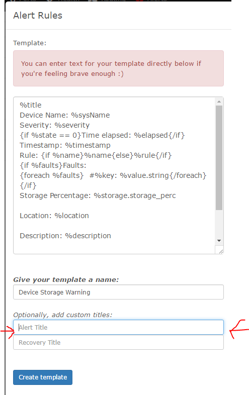

Have you tried modifying the alert template title?
Yes,I have.
As soon as I enter %sysName there alerts stop getting sent to transports.
