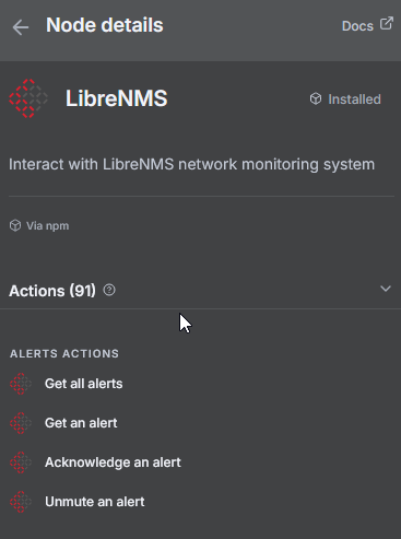

I’m not sure I completely understand what the OP is needing, but I thought I would mention that I found an n8n node for LibreNMS that can process the alerts (See below)
So this might be helpful in the OP getting the alerts from LibreNMS, processing them in the workflow, and then outputing them to some sort of dashboard or alert system. (Grafana, email, chatbot, Telegram?) Depending on the precise definition of “offline” they are using in this context.

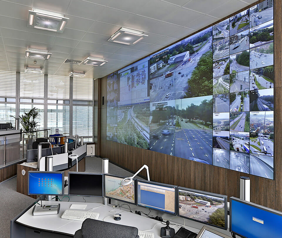

The room are in principal the same as the image posted below:
This is just a random image from google. The point here is I need a notification on one of the screens on the big wall. They are running Windows and they are offline to the rest of the world besides the vlans all the stuff is running on. So running somekid of script on one of the windows computers to interact with Librenms to display notifications is the main goal here.
