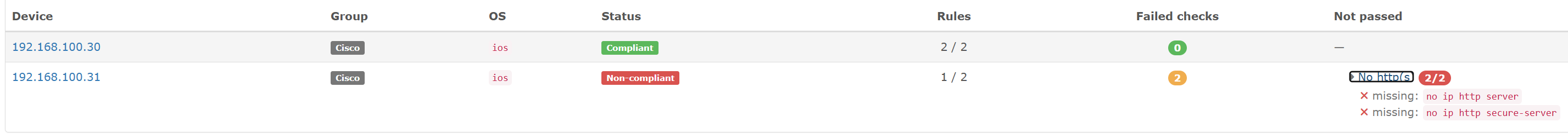

Results overview — per-device compliance at a glance, grouped by device group:

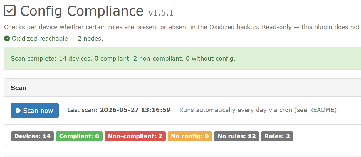

Drilling into a failed rule — it shows exactly which checks are missing:

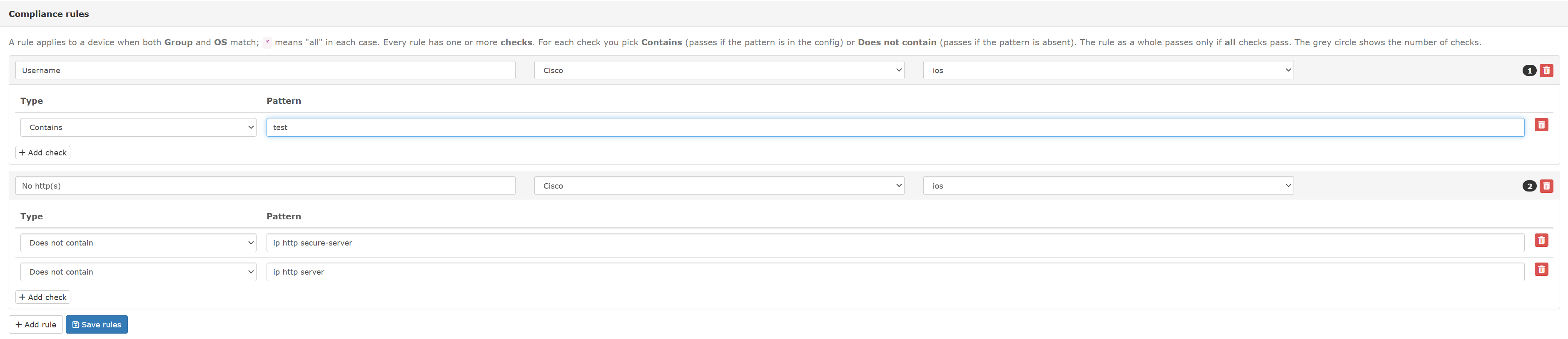

Defining a rule with multiple checks (here a “trusted hosts” rule):
