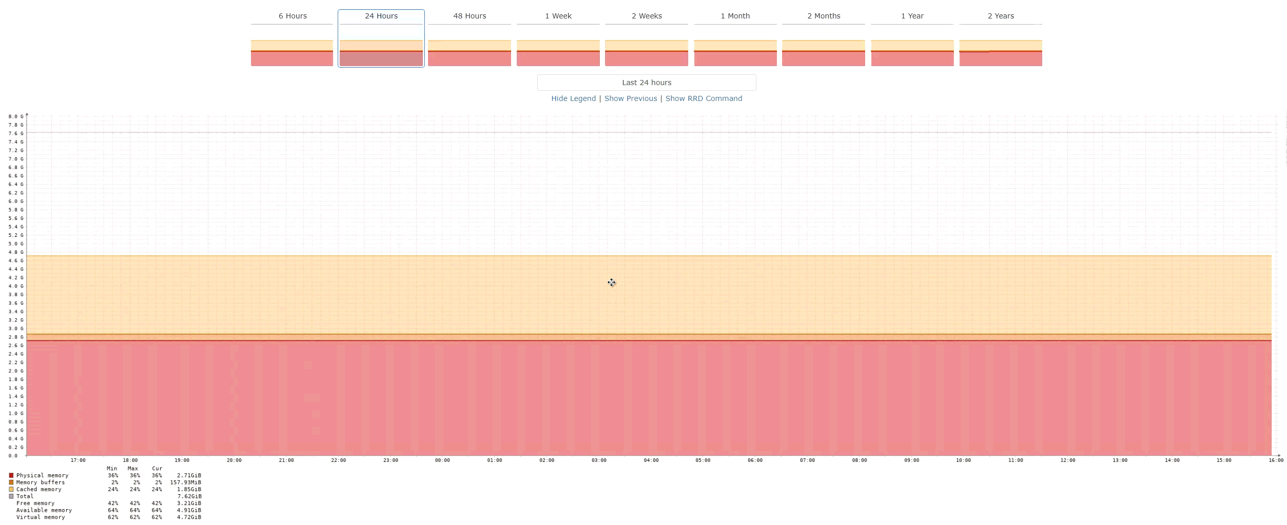

Something seems to have broken in regards to dragging and zooming various graphs.
When you first click on a graph everything looks fine but as soon as you try to drag it left/right it “corrupts” and if you try to zoom it just blanks out.
Quick example:
LibreNMS Graph errors

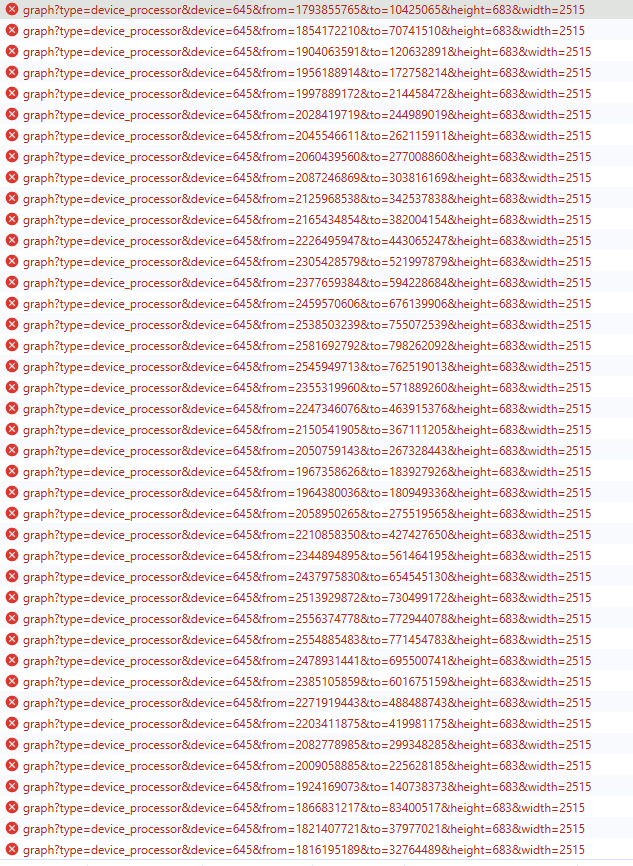

Hmm, can you show the graph urls it is trying? (web dev console network)
I definitely tested that before, maybe some other fixes broke it…
Sure.
/graph?type=device_processor&device=645&from=1793855765&to=10425065&height=683&width=2515
For example errors with HTTP 500
Example when trying to scroll the graph left and right:

Thanks for the extra info. Looks like a to=0 was sneaking in the url :slight_smile:
Yep, that fixed it.
Thank you. :slight_smile:
