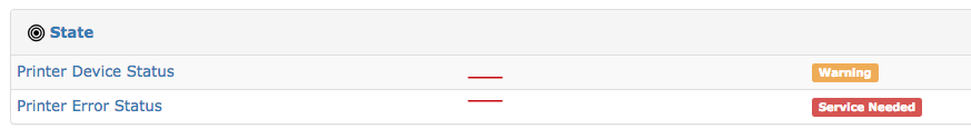

My inbox got flooded since this recent update as well due to a false report on all our printers:
This is a new state that seems to have been detected after this new version.
State sensors are working for me. You should check your printers or perhaps they report the snmpget data badly.

I should have said that I’ve never been alerted for the state of my printers until this morning. I’ll have to change the ā€˜State Sensor Critical’ alert to ignore Printers now.
