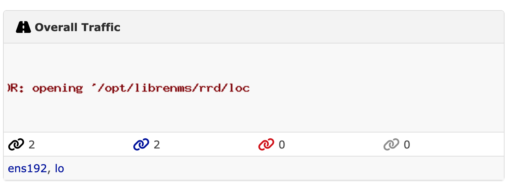

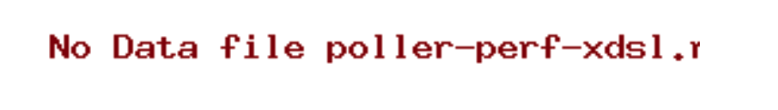

This issue is that no graphs will load including the poller graphs:
I see the files in each of the devices in the rrd/ directory are being updated every 5 minutes

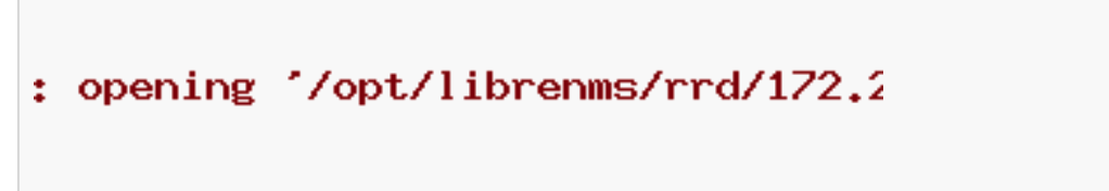

This is the error when i try to load the rrd int he poller -

I fixed this issue. Graphs are working again.
Had to make chanes to SELinux:
require {
        class dir { getattr search };
        class file { lock open read write };
        type rrdcached_t;
        type user_home_t;
#============= rrdcached_t ==============
allow rrdcached_t user_home_t:dir { getattr search };
allow rrdcached_t user_home_t:file { lock open read write };
