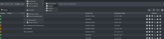

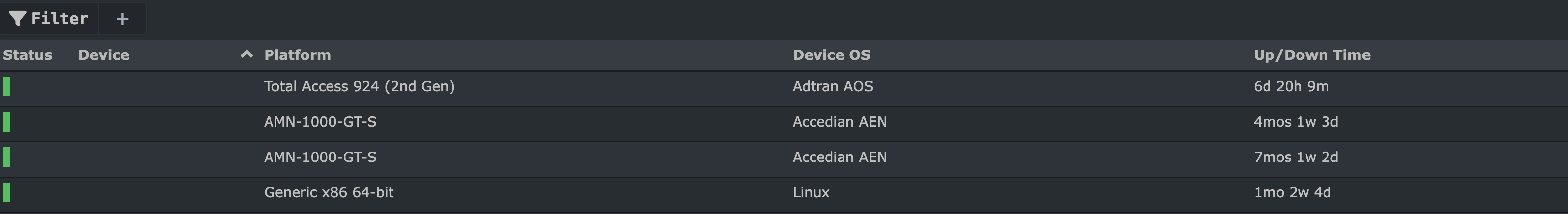

I have several groups in the devices group, in the group manager it shows how many devices there are, they were ok but since the last update, when I click on the group it gives me the whole network.

I am seeing this as well. Device field shows up blank and it just seems to list every device

This started for us as well. All of our device groups are dynamic and the device name field is blank this morning.
Same here. This appears to have happened after an update. You can get to groups using the Filter on the All Devices page and filter by Device Group. It’s not ideal, but a workaround until this is looked into.
Yep, having the same issue here. Using the filter on all device page does seem to fix it for now. Why don’t they post the updates on the LibreNMS page?
