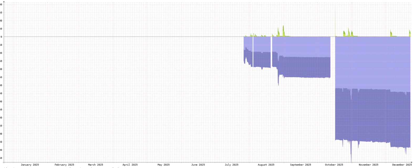

Ever since last Friday my CPU has been working extra hard for some reason. Been running ./daily.sh in hope that would fix it. Anyone else having this issue? Only added a few hosts since last Friday and I`m running about 600 hosts. This server only runs Librenms and as one can see it has been running like 20-30% since last Friday.

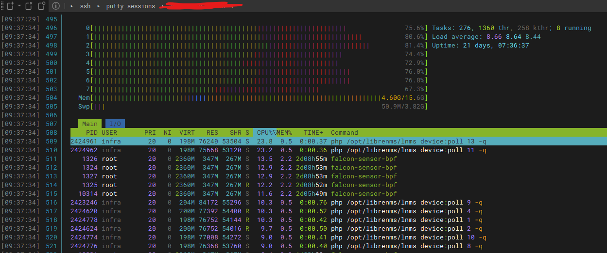

I’ve got an issue in the same ball park:
with 25.11.0 I’ve got an insistent pop-up of poller processes (via htop command monitoring) and very high CPU usage.
Contest: virtual machine on Ubuntu running docker with librenms as a container.
Initially I’ve thought it was since I added a couple of hosts but the pattern was weird. I was able to mitigate by putting the VM at 8 CPUs but it was still around 70% all the time.
Today I’ve reverted the container to 25.9.1 and it works fine, now the VM is basically below 5% CPU usage on average (there are several other containers in here, this is how it was before the CPU count upgrade)
I’m quite new to all of this so forgive if don’t have a log to attach, at the moment I’m not sure where to look and I was kinda in a situation where it was more convenient for me to try to revert it back of 1 release.

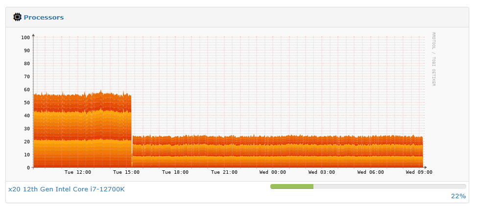

I was about to collect some data and screenshot:
when I recreated (and I’ve done it many times last couple of days) the container with tag “latest” now seems to work as intended: no high CPU e and no poller processes keep spawning during monitoring with “htop”.
I’ll give it a spin for the week end and if something comes up I’ll report and check librenms.log
It has been a couple of ours: usually by this time the high CPU usage would have already settled in. Funny thing is that by recreating the container it didn’t work, it worked with a regression then an update… unless it’s something that has a degenerative behavior it feels like something got stuck in the process :slight_smile:

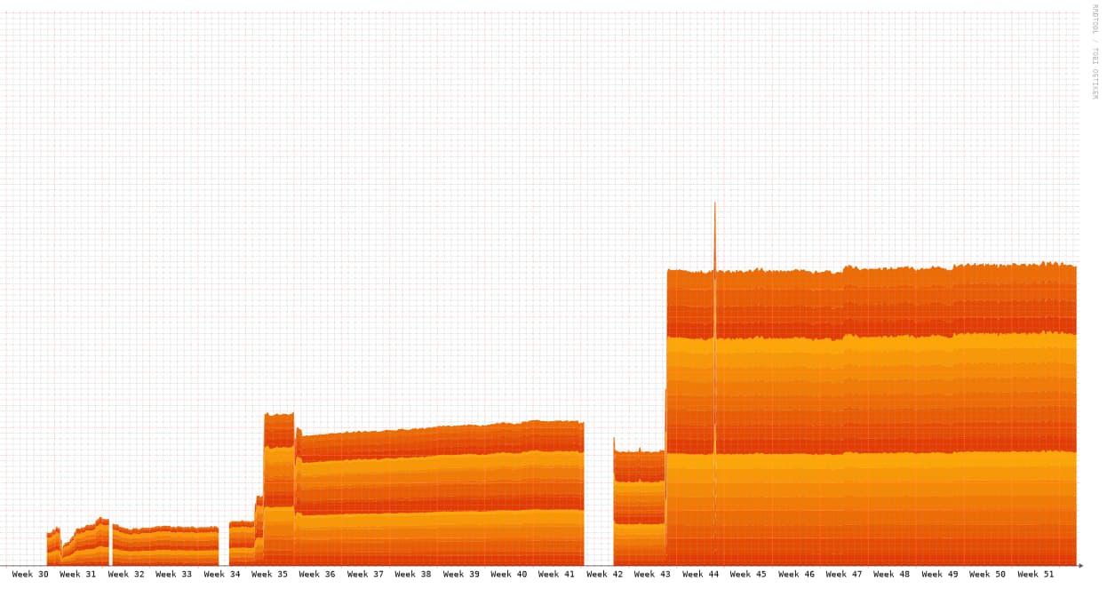

I had the same issue with CPU utilization and found I had both systemd and cron based polling active. I removed my /etc/cron.d/librenms as per this doc and it fixed my issue.
@elherr Thanks for the reply! I did not have double polling enabled!
Just updated to the latest in Debian 13 - still high cpu from week 43 - and since that time I have removed about 10 devices as well. And perhaps I added 2-3 devices in since week 43. So something is using a lot of cpu.

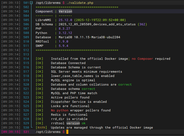

And here is my ./validate.php -

All that mib garbage is from net-snmp on your system (outside of LibreNMS).
I suggest you clean up your snmp conf files.
You can probably test this just by running something like snmptranslate .1
As for your performance issues. You need to look deeper. There is a graph that shows the per-module breakdown of polling time. Maybe check processes and logs to see if something odd is going on.
@murrant thanks for the reply! I will look into it when I have access again! Thanks :slight_smile:
removed snmp-mibs-download*. and poller is down to 39s from 59s and cpu is down to 22% again! Fantastic :smiling_face_with_sunglasses:
