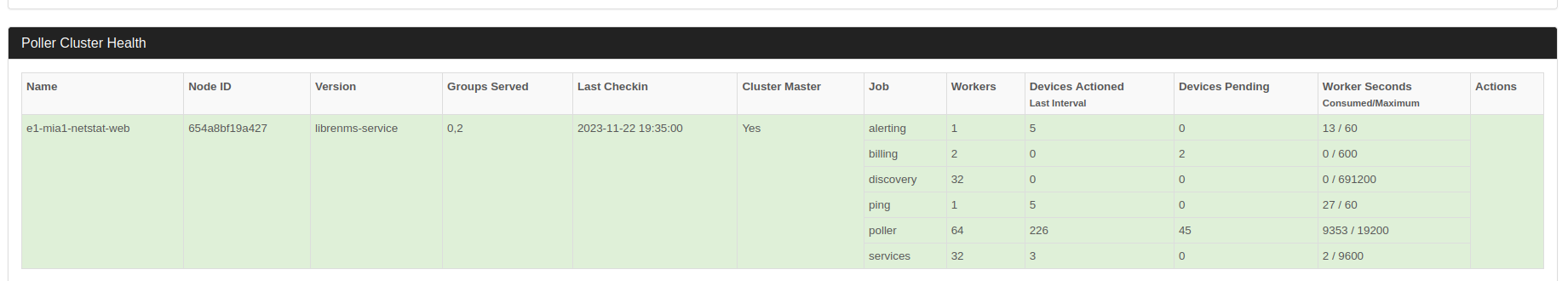

Hi team, I had a Librenms instance with a single poller (polling over 250 devices - 68 pollers 32 workers) running normally. We decided to prepare the environment to distributed pollers. After installing redis i started to see devices as unpolled (even if they are collecting normally). I would like to know if this is a bug or i made a mistake in the configuration

Perhaps the pollers are attempting to use redis for something already.
If you remove the lines from your .env and restart the poller service does the issue go away?
I did remove the configuration from .env and restore the redis config file to default. I did see it connects to the Redis but it did not solve my issue. Could this be a bug? Because even if the device is showing as unpolled, i can see the correct information without gaps on the rdd files or weathermap
