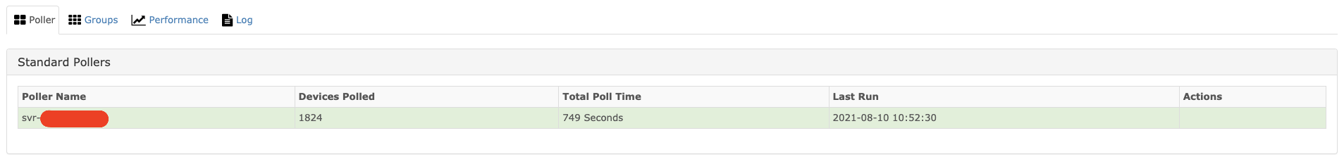

Performance help only have 1 server polling nearly 2k devices
We are polling nearly 2k of devices:
It has 8vCPUs and 16GB mem
We added about 500 devices yesterday and probably will add no more, but the CPU is hitting 100% now, what can we do? I can up the CPUs to 10 or 12 I guess, but can you run an additional poller?
We did have Solarwinds and had a 2nd poller that simply reported back to the main Solarwinds server which had the DB.
Any thoughts would be great.
You are hitting the limit. You need to configure distributed pollers for this.
