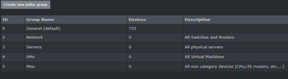

I want to set up polling groups to spread out the polling load.
We have approx 755 devices.
I created the Poller group in webUI. (screenshot attached)
How do I assign devices to a polling group?
What needs to be enabled in my config.php etc…
I am having a hard time finding any instructions on setting this up.
Currently we are just on one system later we will be looking at a load balanced system.

No, just leave the cron timings as they are. poller-wrapper (I’d personally recommend switching to the dispatcher service) takes care of what groups each poller should be polling.
