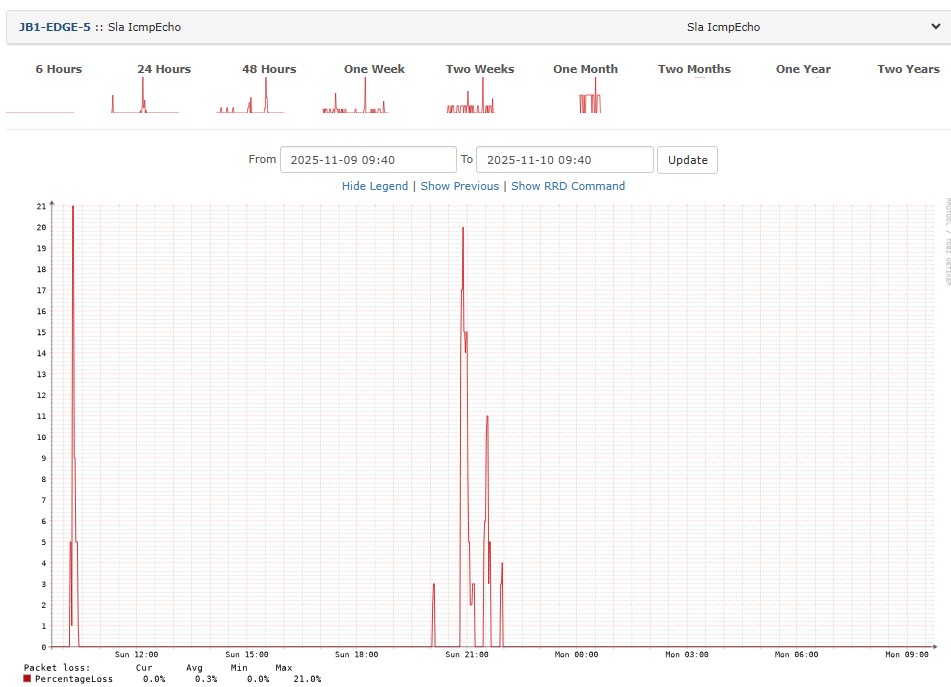

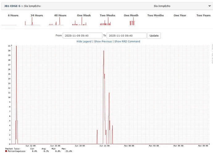

Attached is the icmpecho graph for an SLA / RPM probe on my Juniper MX router show packet loss or percentage loss. I need to create an alert for the percentage loss but looks like the percentageloss values are not stored in the database. I suspect they are stored in RRD. How do I point to this percentage loss figure when creating an alert rule.
I just took a look and the slas database table doesn’t have a column for loss. Someone would need to contribute code to add that column and fill it with data from snmp.
