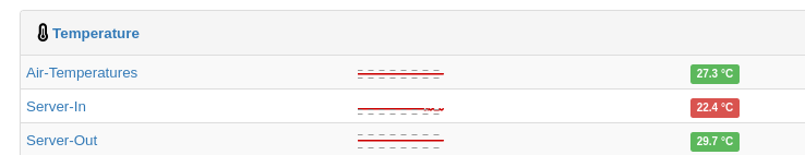

Sélection_011
My LCP is marked as OK (green) but one off is sensor is in alarm :
Is there a way to make my clim10 machine have at least a warning state in the device view ?
Thanks in advance,
Ju
I don’t think there is a way to change the meaning of that status bar. It is green if the device has been up for >24h (or customize that time). It doesn’t relate to alert rules.
