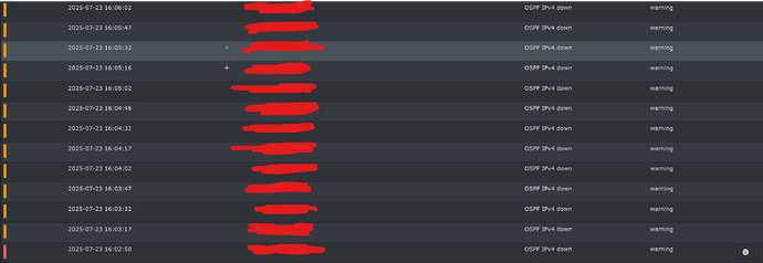

We did some additional testing and noticed that this issue is related to the “Interval” setting. According to the tooltip, setting the Interval to 0 should result in only one notification being sent while the alert remains active. However, that doesn’t appear to be working as intended.
Alerts when Interval is 0:
As shown in the screenshot, the initial alert notification is sent at 16:02:58 and is followed by many “Has worsened” notifications for the same alert.
As a workaround we changed Interval to 5 minutes and the repeated notifications stopped.
Could this be a bug related to the Interval setting?

What’s throwing me off though is that this wasn’t happening before upgrading to v25.5.0. The alert config and query stayed the same but the notification behavior changed right after the upgrade. So I’m wondering if something changed in how alerts are handled now?
The goal of using alert interval set to 0 was that when a device sent OSPF down syslog, we would get one notification only, even if the link flapped a few times within the 5 min query window. After the version upgrade, without any change to the alert rule, we are now getting the “better” or “worse” alerts based on count of syslog messages within the last 5 minutes.
After some testing, it looks like there may be a bug or behavior change with interval=0. When set to 0, it is still sending multiple worse/better alerts before recovering.
