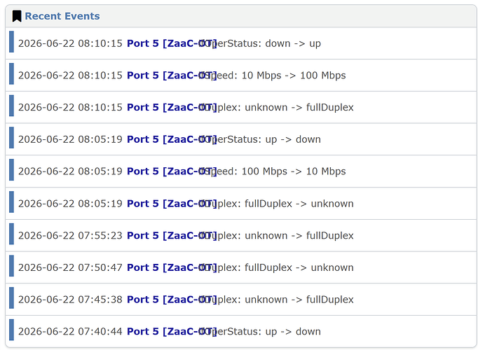

After updating LibreNMS to the latest development version, I’ve noticed a rendering issue in the Recent Events widget on the dashboard.
The event text is overlapping itself, making the widget difficult to read. It looks like the device name/link is being rendered on top of the event description.
Screenshot:

The issue only appeared after updating. Other dashboard widgets seem to render correctly.
Has anyone else seen this, or is this a known CSS/UI regression in a recent commit?
