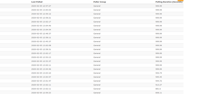

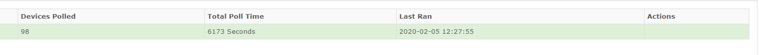

Before the upgrade the polling usually went under 120 seconds, now the polling time is between 6000-12000 seconds.

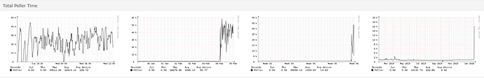

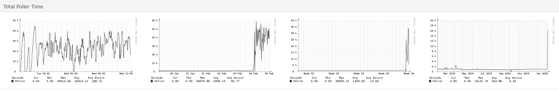

What do you see in the performance graphs? Is there a specific module that takes a lot of polling time?
Do you monitor cisco ios devices?
http://yourlibre/pollers/tab=performance
It’s mostly Cisco devices and the performance tab shows only the attached information so not sure what to look for.

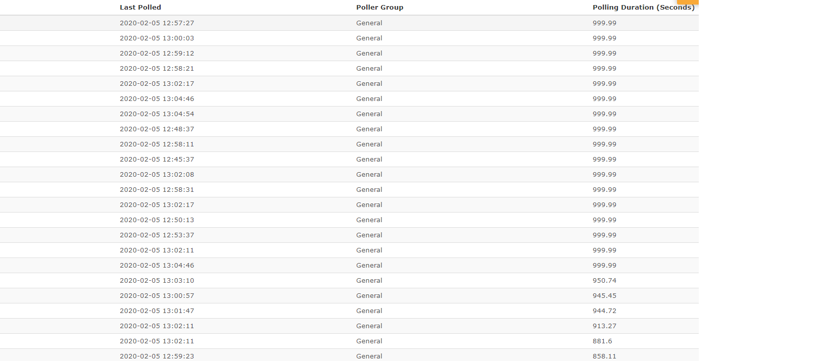

Check if you have any old poller.php processes running > 10 mins. If so, kill them all.
Had a ton of poller.php processes that were over 10 minutes and I killed them all, they started afresh but are building up again so still having the same problem :frowning:

After running daily this morning it looks like the polling time has gone down to 68 seconds again :slight_smile:
Will monitor the poller during the day, thanks everyone for the help.
