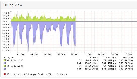

I need to use traffic bills for downstream clients some of which have multiple ports with us for the same service/bill. I have created bills of type CDR 95th. The 95th percentile calculation is based on Max In/Out. The problem I have is that the calculated 95th percentile figure is incorrect. Its too big compared to the actual usage. I have seen a couple other posts on this from 2018 but no actual solution. Looking to see if anyone has found a solution for this.
An example, on the report below the clients traffic is less than 1 Gbps but the calculated 95th percentile is 5.11 Gbps which is obviously not correct looking at the combined traffic graph.
