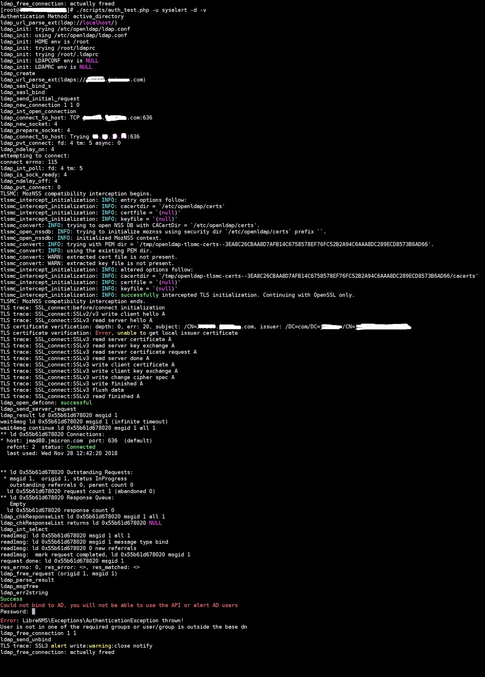

AD Authentication test fail
I can’t complete the setup about AD authentication , Error message is generated when I execute auth_test.php.
Error messages

Try changing auth_ad_check_certificates to false instead of 0. I have that set to true and mine works fine.
Hi John:
Thanks Your replay.
I change auth_ad_check_certificates to false , also have the same error.
I I have solved this problem
