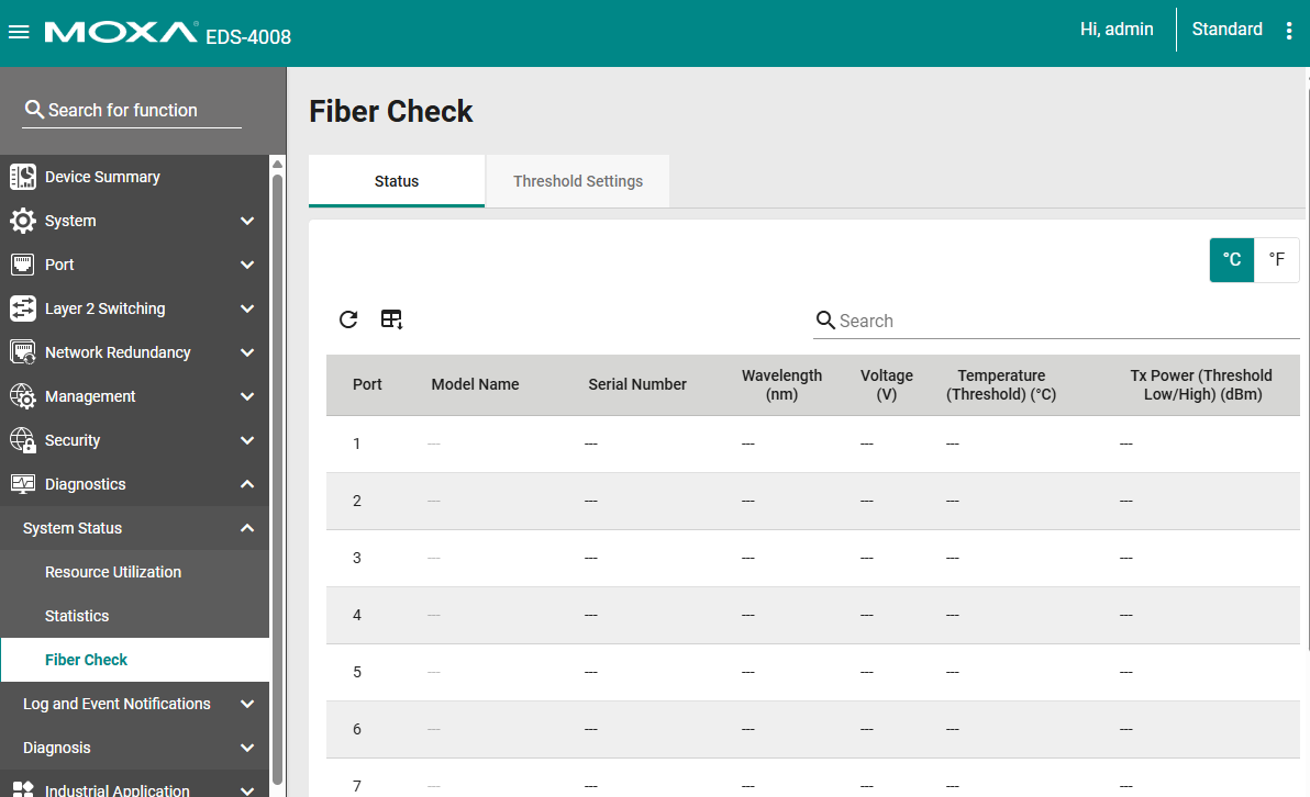

none of the 3 have fiber SFP or POE?
Sorry, I was out with the family and didn’t see your message.
Each of those switches are actively using SFP and POE. I’m not sure why they’re not showing up in the SNMPWALK.
I can poke around today.
strange, ill try again.

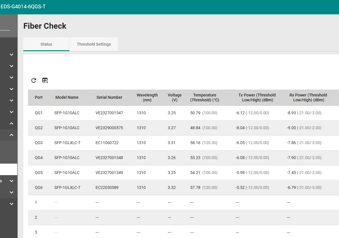

is there anything in your fiber check menu?
Yessir! I have entries for QG1 through QG6 (looking at the EDS-G4014 specifically).
