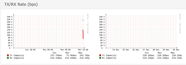

it’s working finally we have some rate to graph, but the problem value only detected as Kbps, it should be Mbps (already compared with live radio, the number is correct)
so question is how can we add multiplier ? i want to multiply it by 1000 so it will display correct number

i have 2 ptp link using AF5XHD see what happen when using snmprec.py
1st link
1.3.6.1.4.1.41112.1.10.1.4.1.3.24.232.41.30.54.151|2|142720
1.3.6.1.4.1.41112.1.10.1.4.1.4.24.232.41.30.54.151|2|214080
2nd link
1.3.6.1.4.1.41112.1.10.1.4.1.3.24.232.41.30.88.103|2|180224
1.3.6.1.4.1.41112.1.10.1.4.1.4.24.232.41.30.88.103|2|268800
no wonder my 2nd link are not detecting new wireless sensor
