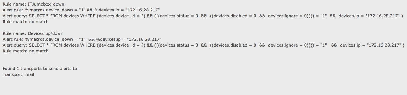

https://docs.librenms.org/#Support/Device-Troubleshooting/
Use that to debug the alerts, it will show you if the rule matches.

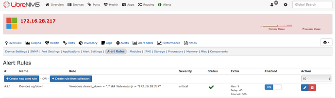

Thanks. When I run this, I get the screenshot attached. I am not sure why it says “no match”
I mapped the device by ip. Any thoughts on why it’s not matching?
Possibly because there is no device that is down that has that IP?

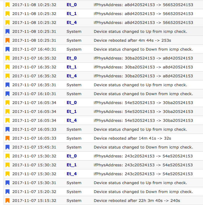

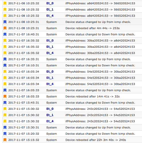

I have rebooted the device numerous times
and it gives me a down reading. But nothing triggered in the alerts.
try with the sysname
now it works. still used the ip. thanks for all help!
