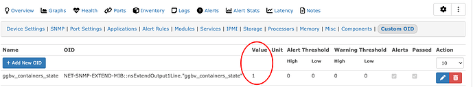

I was able to identify the OID and query, and I injected it into the customOID.
Is it possible to track the values and their corresponding meaning in LNMS? How can I create alerts based on this? Do I absolutely need to use SQL queries for this?
With the Custom OID feature, you can track the values but not he corresponding meaning. All Custom OID does it poll a single OID and it expects a numeric response only. If you need the corresponding values, you would have to develop proper device support.
You shouldn’t have to use SQL queries. If you go to your device, click the settings Cog then go to Custom OID, you should see the last value it polled.
Hopefully, it’s working properly and you see the value you expect. Looking at your MIB screenshot, it looks like 3,4 and 5 are the expected/good values, so you could edit this OID and set 6 as the high alert threshold and 2 as the low alert threshold. Make sure Alerts Enabled is checked.
Then, go to Alert Rules and click Create rule from collection. Search for customoid. You should see 4 options.
Add ‘CustomOID over limit’ and ‘CustomOID under limit’. Rename as appropriate and probably limit it to devices or device groups.
