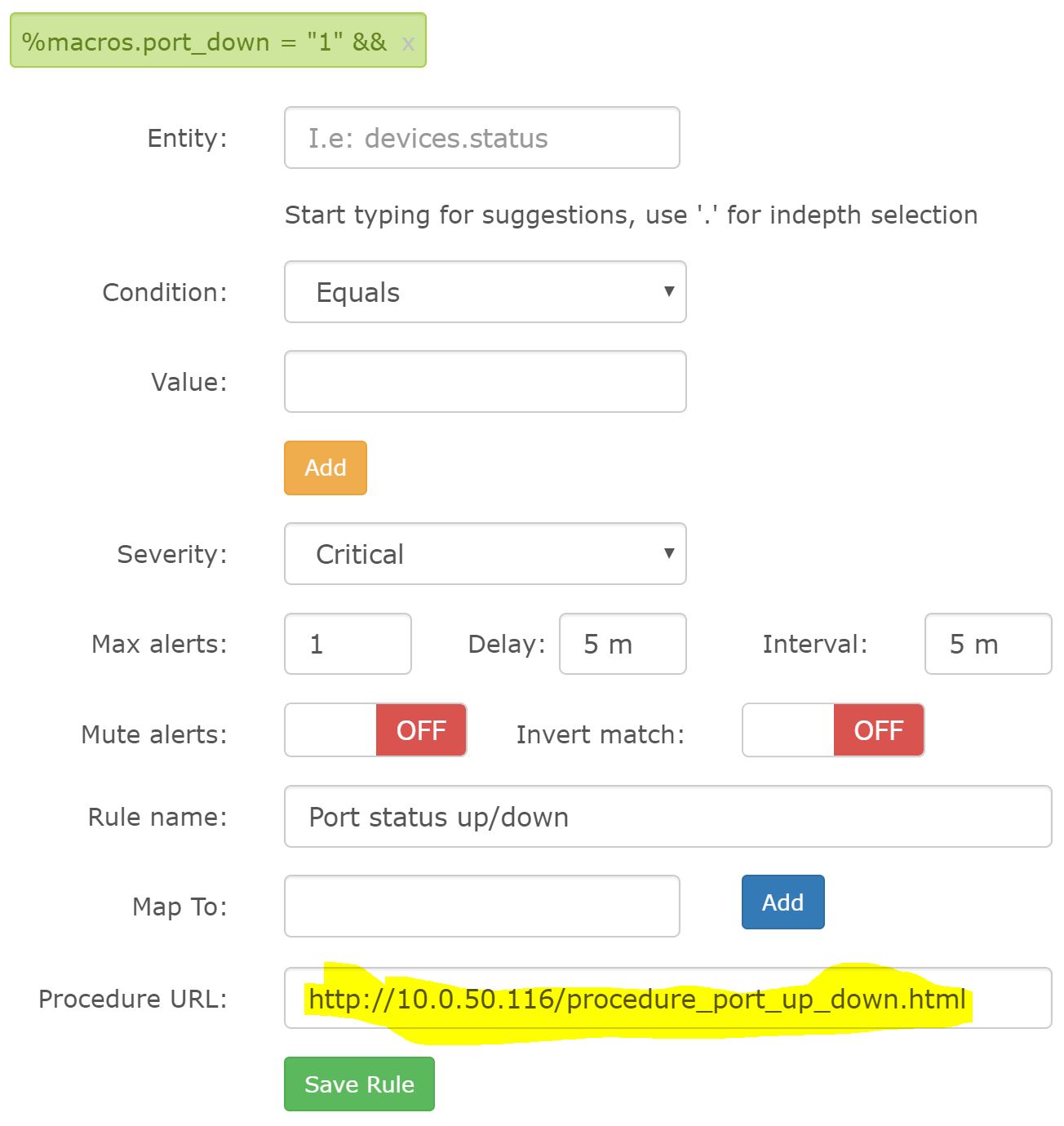

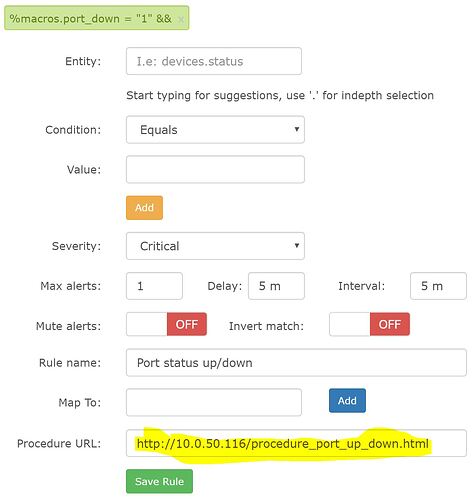

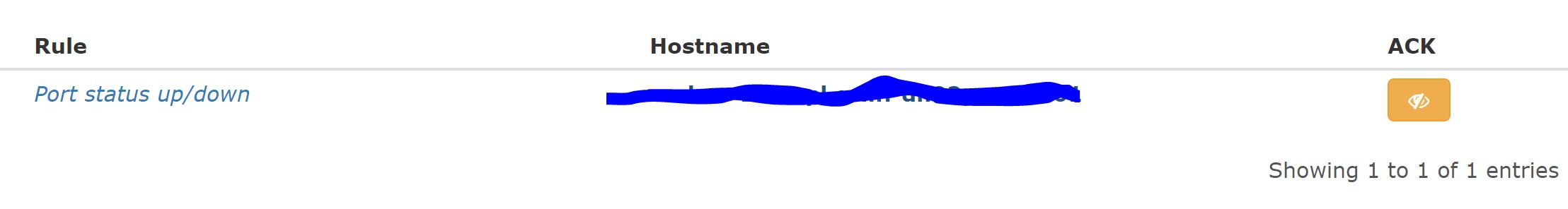

I noticed today that alerts which have a procedure mapped aren’t showing the “Open” button on the alerts notifications page anymore which lead to basic instructions on handling an issue. Any ideas what might have caused this? Screen shots are attached.

Also, I’m unable to replicate that issue with the link missing from the alert rule. Have you tried deleting the alert rule and then building it back?
Removing and re-adding the link didn’t produce a change sadly…

Removing the rule and re-creating it did not lead to any change on the procedure icon/link.
hmm just for testing try adding a random address in the procdure link
Changed it to http://google.com and same result. Thanks for taking the time to help with this btw…

Wait is the link not showing in the alerts widget?
The link shows up in the alert settings widget if that’s what you meant? It’s not showing the procedure “button” on the alert notifications page for active alerts like it used to.
Yes… So it shows in the alerts widget but not on the Alert Notifications page. I see the same also. Possible a bug?
