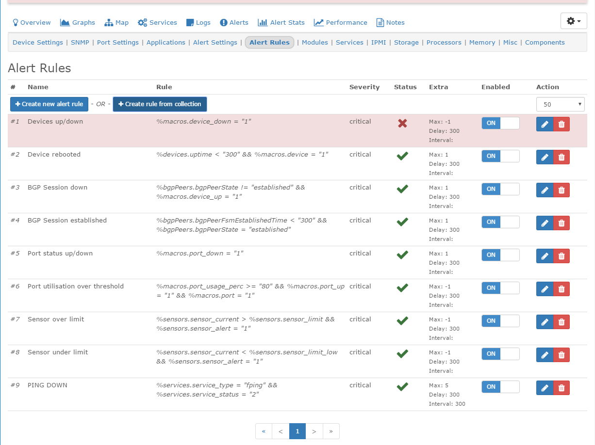

About Alert Rules, isn’t possible disable X rules per Host?
Im asking because when i disable X Rule inside a Host config, that Rule is disable for all Hosts instead of current host.
In short, If I need disable SNMP Alert Rule for host 8.8.8.8, I need disable for all hosts?

Are you asking if you can only disable a rule for one device? If so then No not at this time. When you disable an Alert Rule it doses it globally.
Yes, thats my question… Really its bad :frowning:

Yes i know, I use service fping for that, but I have servers with SNMP and without SNMP.
If I disable alert %macros.device_down = “1” it will be disabled for all servers included the SNMP servers :frowning:
Ah i got it. Try this disable that rule and use this rule it checks only for ICMP response.
%macros.device_down = “1” && %devices.status_reason = “icmp” &&
Yes, that way works.
