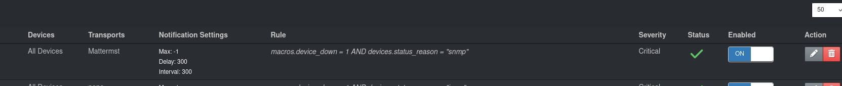

I can click the transport Test tick button here and successfully get a message in the channel in Mattermost, but if we assign that same transport to a Rule for example as below
it fails, as mentioned earlier we’re on a disconnected environment, so we have our own CA, we’ve mounted the CA files in the docker container and since then the test button from the initial screen shot worked, if we run test-alert.php ( Testing - LibreNMS Docs ) with the rule from above the message goes to Mattermost with all the relevant info, but in the Device Overview UI we see SSL Certificate errors under Recent Events and no alerts in MM.
