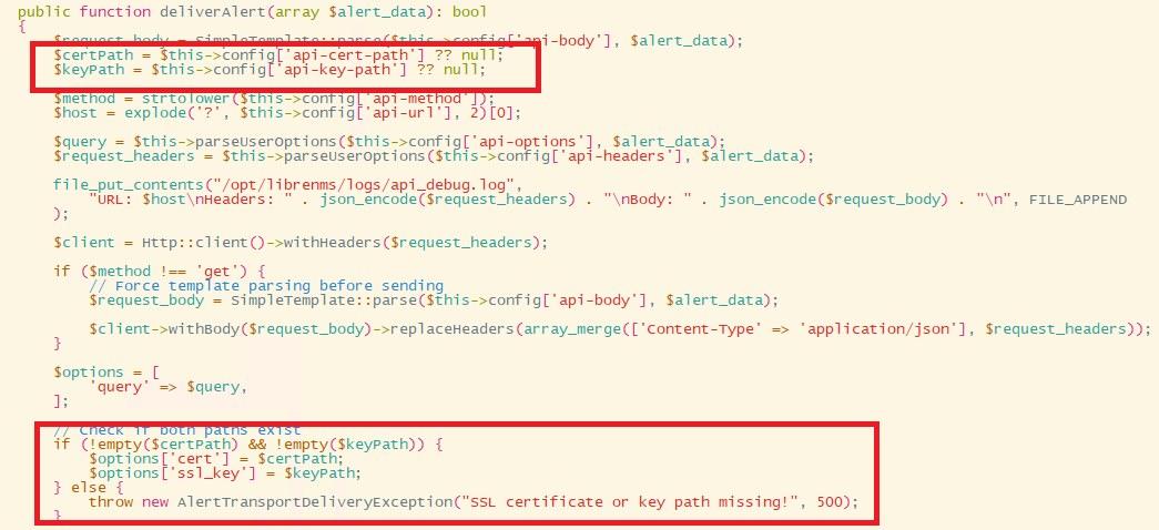

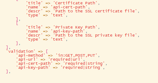

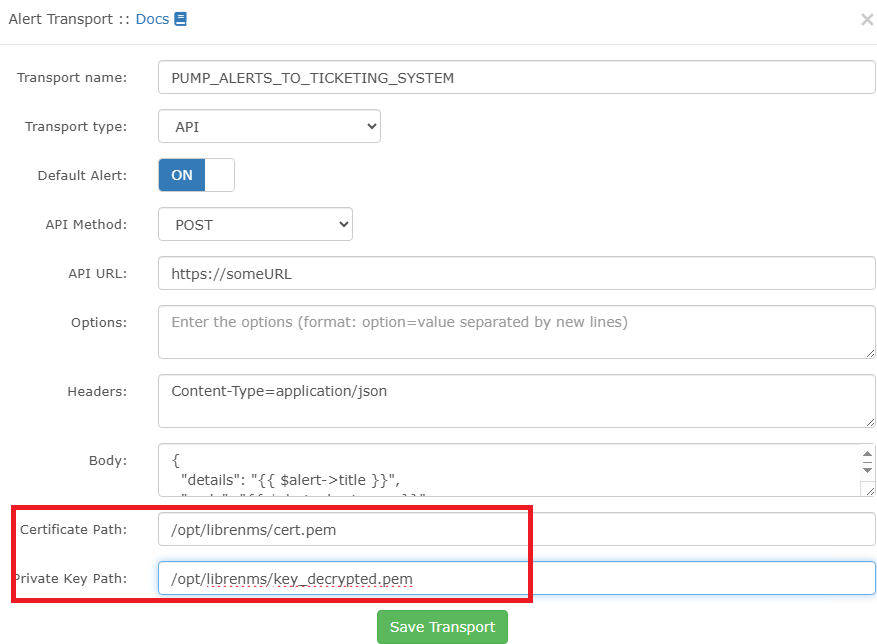

I have a ticketing system which can be accessed only by authenticating to it using cert and key.
I made below changes to Api.php file to add cert path and key path fields to the Alert Transport API GUI as shown.
I am trying to invoke ticketing system using this new API alert transport but I am getting error, when I do the same with CLI curl command with same cert and key I can successfully invoke our ticketing system to create a ticket.
what ever I am trying to do, is it supported? or am I doing something wrong.
ERROR:
Test to api failed
Transport delivery failed with 404 for : {“code”:“NotFound”,“errorCode”:null,“message”:"Unable to find workflow
MODIFIED CODE:
I’ve created a few custom transport to integrate with Slack Workflows and AWS Cloudwatch by simply adding a new transport class. I haven’t attempted to do what you’re doing here, but if you need to use mutual TLS, I’d probably create a new Transport as well (LibreNMS updates to Api.php will likely override your changes). Additionally, I’d suspect you’d have to invoke some php library as part of your $client to establish the mutual TLS handshake. It seems like you’ve just added fields here?
