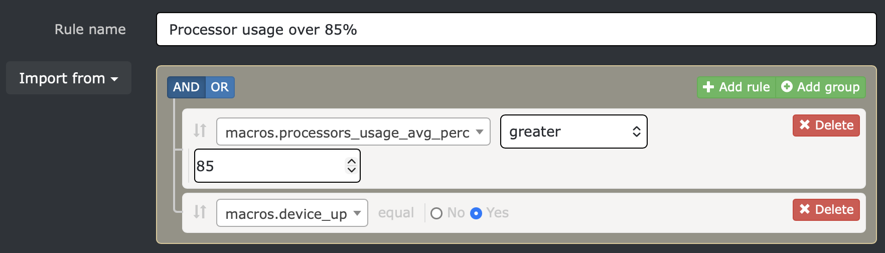

I am trying to implement the solution that is provided in this post:
It seems dead simple. I’ve defined this macro:
bash-4.4$ lnms config:get alert.macros.rule.processors_usage_avg_perc
(SELECT AVG(%processors.processor_usage))
I’ve got the rule set up in the alerts:

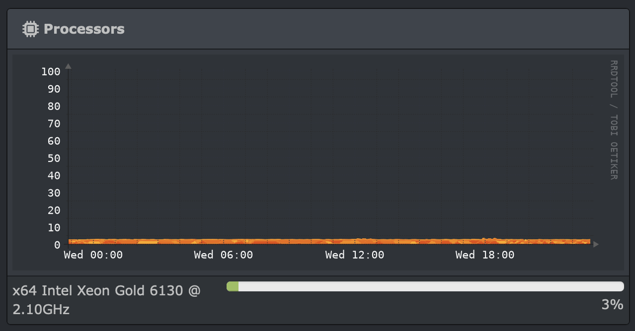

But this thing is going off every day for what looks like is 85% of a single core (as luck would have it, it isn’t right now, but it was a few minutes ago when I started writing this post).
You can see, the most recent machine to alert on this has not come anywhere close to 85%:
