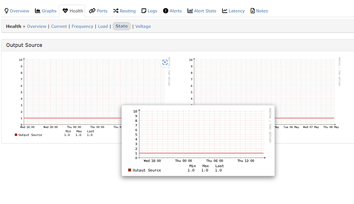

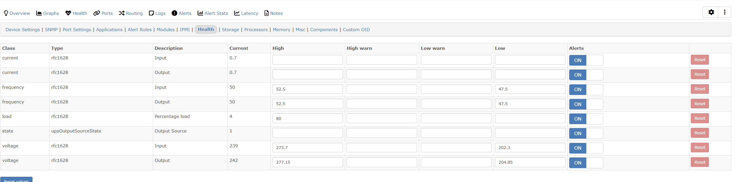

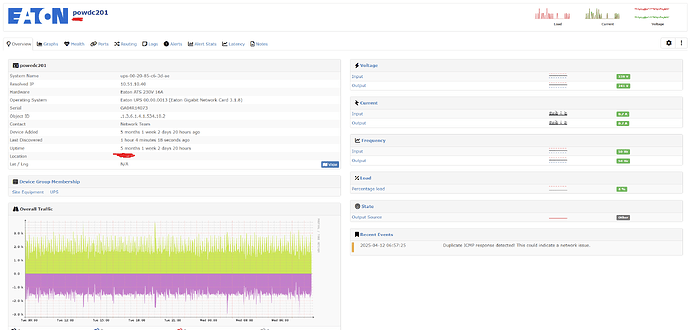

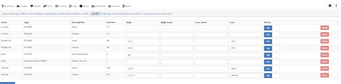

I have one of these in our network and it works with LibreNMS. Happy to answer any questions you may have. See attached.
Eaton ATS 230V 16A
Thank you very much for taking the time to respond. Can you see which source is active in the inputs and the logs of the transitions between inputs?
I’ll be honest testing this unit with LibreNMS I didn’t do when I got it provisioned into the network. I suspect the output source state (pictured) will use values based on whats going on such as lost A feed, or lost B feed ect and then to build alarms around those states. I dont have any records of the logs due to pulling a cable (and not in a position to test it sorry). Happy to provide discovery/poller logs if you want to dig deeper in what its capturing.

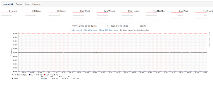

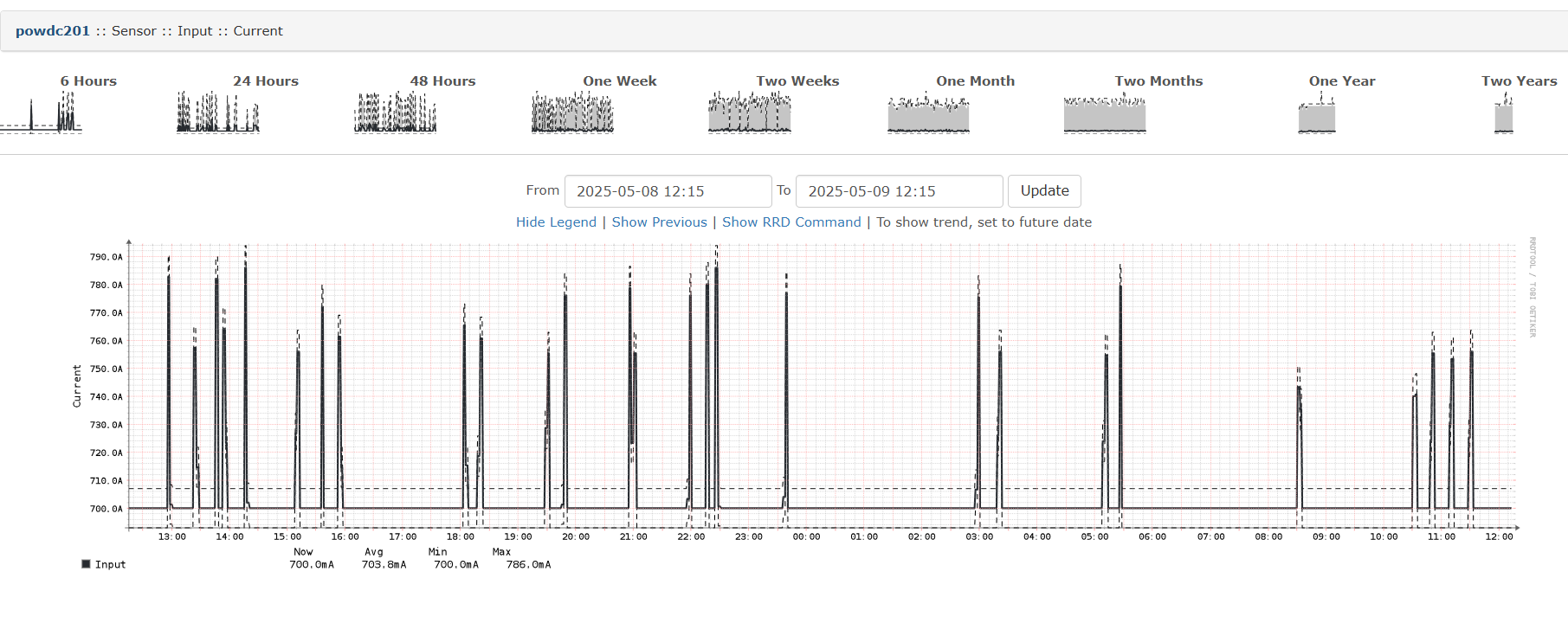

I have one last request. Can you share your input screens?
