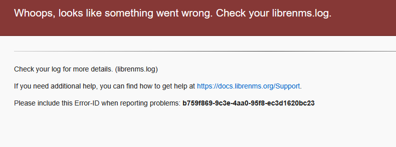

Auth with AD Failed after update librenms´s version
    - Try log in with AD users on librenms
     - logs:
     2025-03-14T11:35:30][ERROR] Typed property LibreNMS\Authentication\ActiveDirectoryAuthorizer::$ldap_connection must not be accessed before initialization {"exception":"[object] (Error(code: 0): Typed property LibreNMS\\Authentication\\ActiveDirectoryAuthorizer::$ldap_connection must not be accessed before initialization at /opt/librenms/LibreNMS/Authentication/ActiveDirectoryAuthorizer.php:231)"}

I am assuming you are using OAUTH, so go through the setup for the socialite config again, I think the composer get reset and removes the module.
I think the fix is lnms plugin:add socialiteproviders/<insert yours>
After update back normal to login
