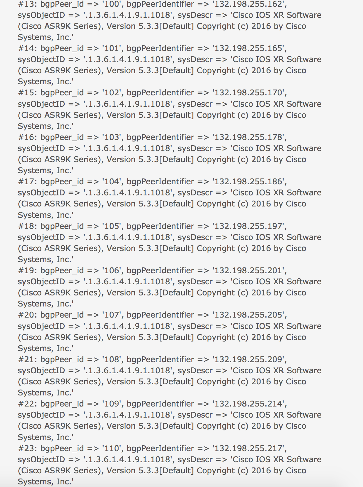

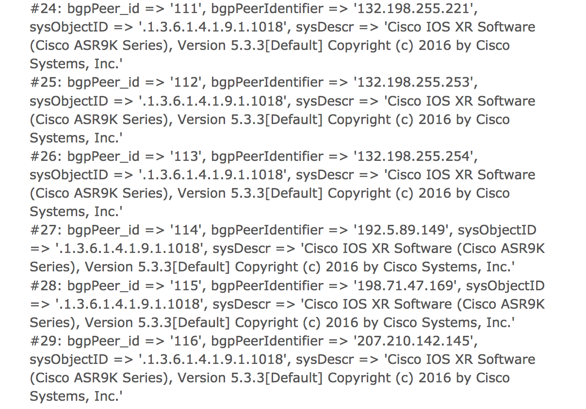

Try to collect:
./discover.php -h affected-device -m bgp-peers -d
./poller.php -h affected-device -m bgp-peers -d
and check output for problems.

@mvoity Hm if no visible signs try to save output into file, then revert bgp-peers update commit and collect again, after that diff outputs to see differences. Usually last part of discover with sql inserts is most readable for comparison.
Here is the output -
Nothing is jumping at me -
https://pastebin.com/9kxwRAjx
@mvoity Ah i forgot that discover.php for Cisco only show peer list, status changes tracked with poller.php where shown all peer stats and its safis stats. Output seems fine, try to grep it for neighbor which status you expect parsed wrong and track all its occurancies.
