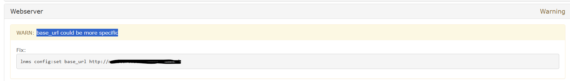

- Ran “Validate Config” from the UI : validation indicated the “base URL could be more specific”
- Checked the alert settings : still invalid
- Ran “Validate Config” again : everything passed (base URL message was gone)

- Ran “Validate Config” : first time it shows the base URL warning
- Ran “Validate Config” again : warning is gone, everything passed

Screenshots of the WebUI are attached.
