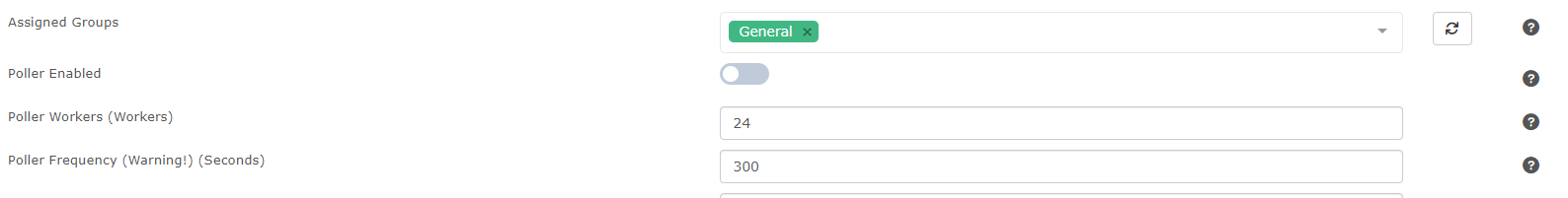

Would it be deactivated here?
How can I deactivate the dispatcher service?
Here
here you can remove standard pollers
to stop dispatcher service,stop below service
librenms.service
Poller is deactivated
In addition, I have also stopped the librenms service but I still get the following message “[FAIL] Both Dispatcher Service and Python Wrapper were active recently, this could cause double polling”, when I run ./validate.php
Is it necessary to make any further configuration?
after disabling , if you run validation immediately . it gives the same error. did you try after some time.
