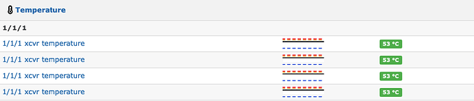

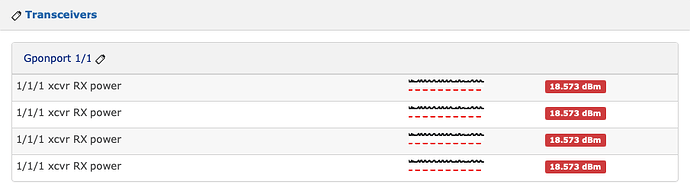

Recently on these kind of devices:
Hardware:Calix E7-2
Operating System: Calix EXA 3.4.51.25 (2x gpon8)
Noticed that the GPON interfaces have the same values on Transceivers, Temperature and State sensors multiple times.
I’ve attached 2 pictures to better understand.

Did anyone else got this issue ?
Check out this thread from yesterday. May be the same issue. You’ve got the updated version, so try manually running discovery.php and see if cleans up the dupes.
