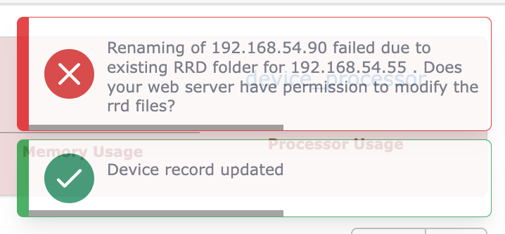

This time I´m having issues with changing IP adress of one device. I have not tried other devices so I will focus on this device first.
Whenever I try to change IP I get this fault:
(The record is not updated - falls back to the old IP)
This probably happens because I moved the rrd/ files from place to another when I did a backup. After I moved the files back to /opt/librenms/rrd and re-ran all the chmod-stuff in the debian guide. So the permissions in /opt/librenms/ should be okay, but alas they are not.

And the output of the 192.168.54.90 folder:
librenms@nms:~/rrd/192.168.54.90$ ls -la
total 1700
drwxrwxr-x+   2 librenms librenms   4096 Aug  1 03:50 .
drwxrwxr-x+ 577 librenms librenms  20480 Aug 16 13:51 ..
-rw-rwxr--    1 librenms librenms 171272 Aug 19 11:50 availability-2592000.rrd
-rw-rwxr--    1 librenms librenms 171272 Aug 19 12:15 availability-31536000.rrd
-rw-rwxr--    1 librenms librenms 171272 Aug 19 11:55 availability-604800.rrd
-rw-rwxr--    1 librenms librenms 171272 Aug 19 12:00 availability-86400.rrd
-rw-rwxr--    1 librenms librenms 849128 Aug 19 12:10 icmp-perf.rrd
-rw-rwxr--    1 librenms librenms 171272 Aug 19 12:05 poller-perf-availability.rrd
librenms.log gives me nothing during the saving
