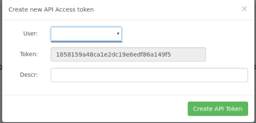

When i try to add a token on the GUI i cannot get a dropped down menu of user(s). Which gives me an error if i try to create anyways.
At first i thought it was because there were only one user that had logged in but i logged in as a dummy user and still not drop down list of users to select.
I am authentication with ldap.

screen_2018-03-23-14-40-28
Using Google Chrome Browser
screen_2018-03-23-14-43-43

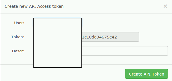

Using Microsoft Edge Browser:
screen_2018-03-26-09-32-46
:frowning_face:
I know it’s fashionable to have a downer on Edge - but it really does suffer on both sides - if you’re an MS superfan, Edge does not work with (MS) Sharepoint… on the other side it appears not to support standards too well either (depending on the exact version you have)
Try using a current version of Firefox or Chrome (or Safari, or some other properly standards-compliant browser).

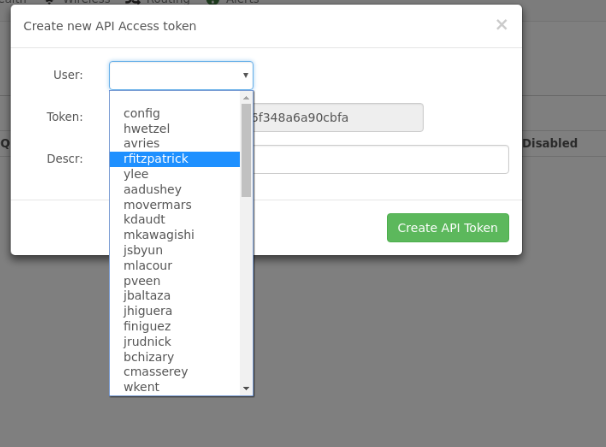

Thanks to PR i can now see my user drop down list
screen_2018-03-29-14-20-21
:grin:
Summary is we accepted a change to improve the speed of listing all users, but some ldap servers don’t have memberOf enabled. So for those, we try the fast way, then revert to the slow way.
If you want to enable the fast lookup:
https://www.openldap.org/doc/admin24/overlays.html#Reverse%20Group%20Membership%20Maintenance
