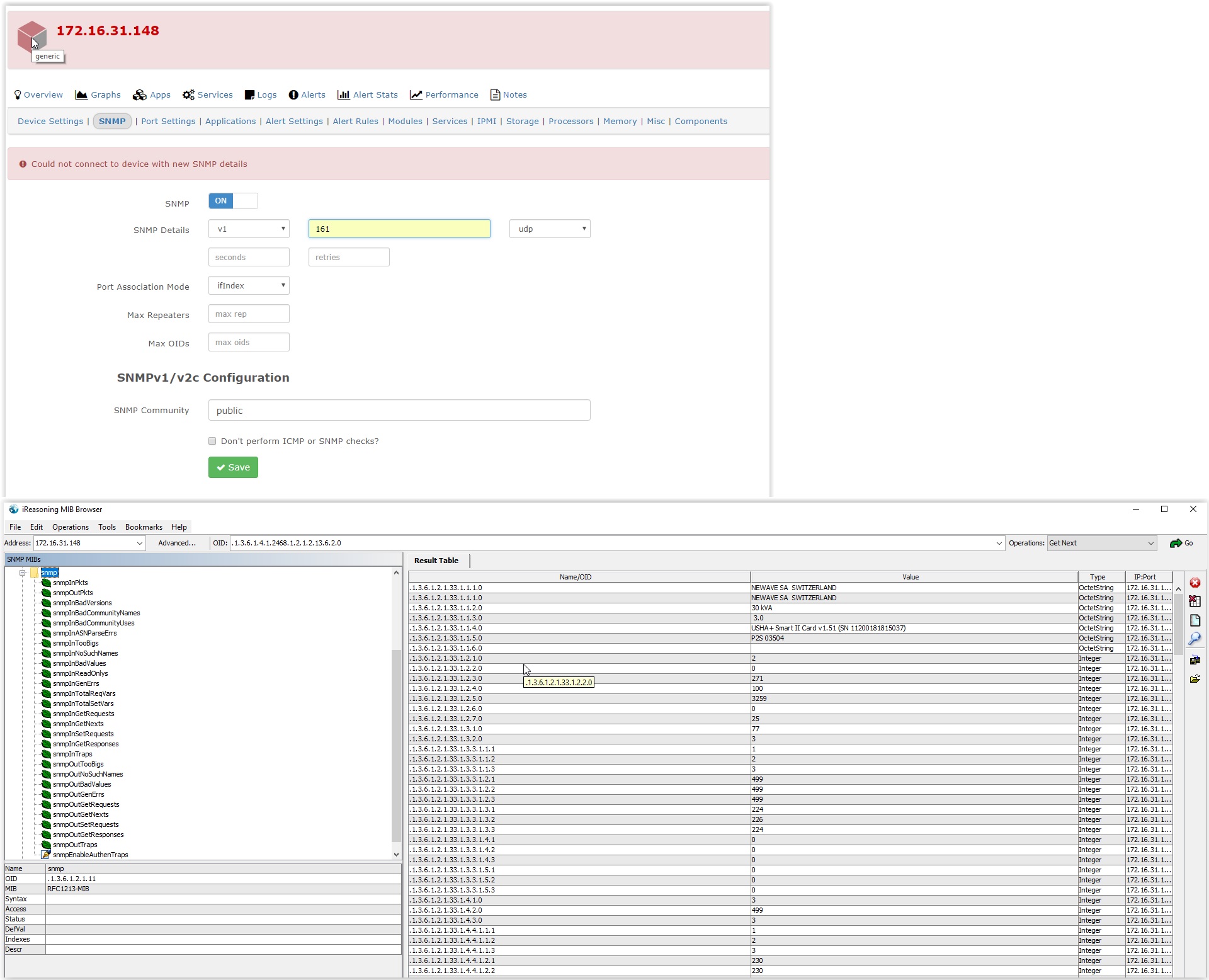

i check the settings of the SNMP of the ups, with MIB browser and everything looks fine.
I cant understand why.

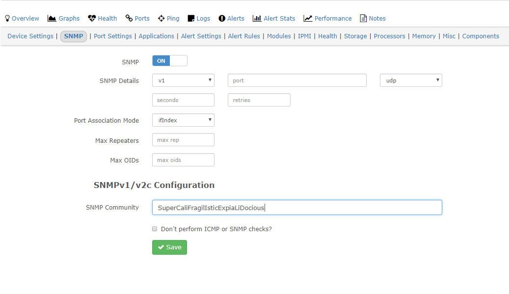

Try changing SNMP details to v1 Our Eaton UPS will only accept v1
(Do not use a long community string, that is for Public Obfuscation only.)

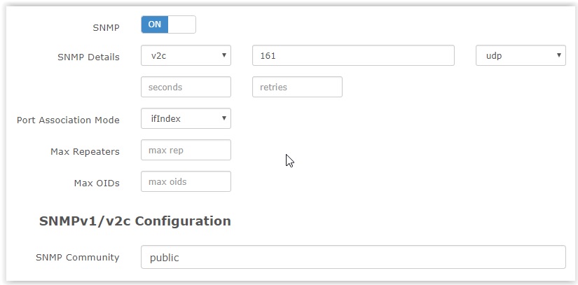

Thks for your replies.
I tried to change in V1. the some problem. in the picture i have the test too

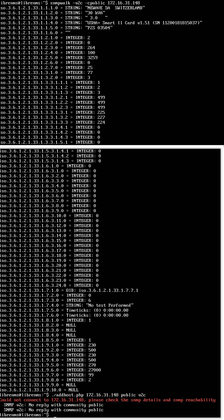

can you, from librenms server, do snmpwalk -v2c -cpublic 172.16.31.148 .??
Does it answer? Maybe the community you are using is incorrect. Are you sure it is “public”?
i deleted it and i tried to add it again. plus i made the check you said.

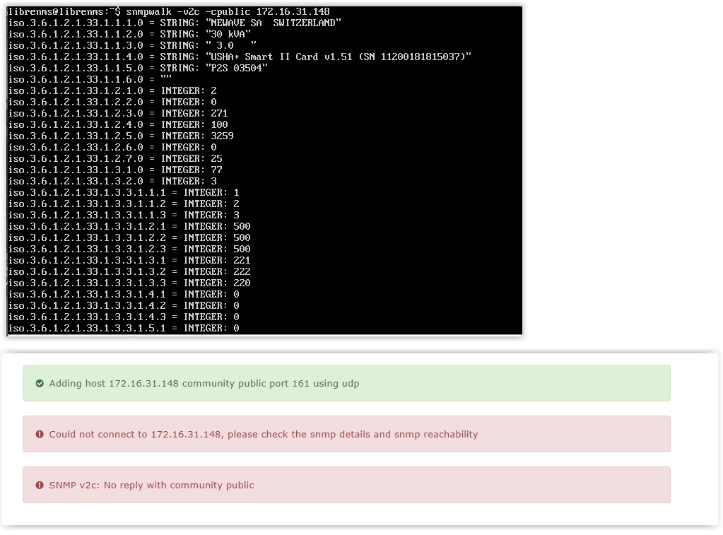

Please, try to add it from cli with:
./addhost.php 172.16.31.148 public v2c and check what is failing.
the funny thing is that it respond to the check and not when i want to add it

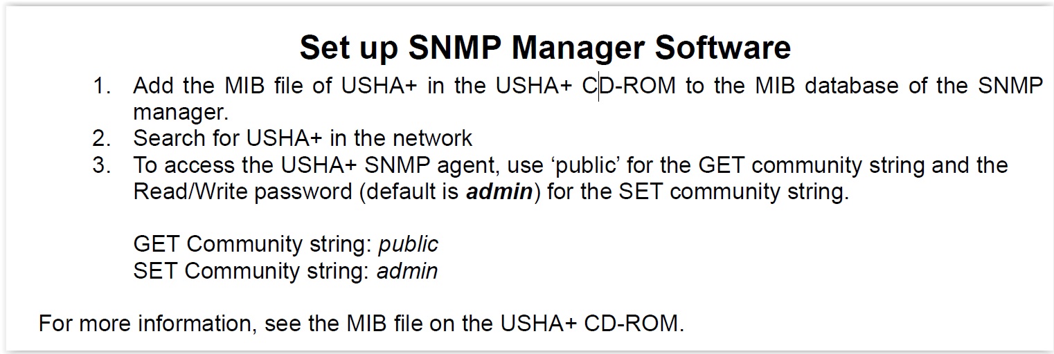

i find this. can anyone tell me where in the SNMP manager must put this files and how.
