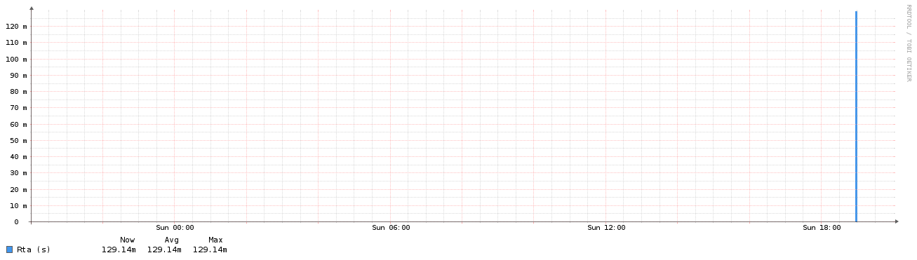

FYI I’m always testing, I’ve something strange with the graph and I can’t determine if it’s a cron problem or a SElinux problem.

hi again, i removed the fping service and added it again, this time and after 1 day of service adding it shows that "service not yet checked"
any new comment for this?
Hi again, Finally it seems its working and i have the graph, but there is another issue that the fping service seems is not running continuously and so i have not a continuous graph, there is only one time check.
what i can do now to have it continuously?
