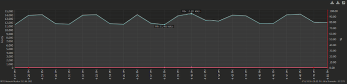

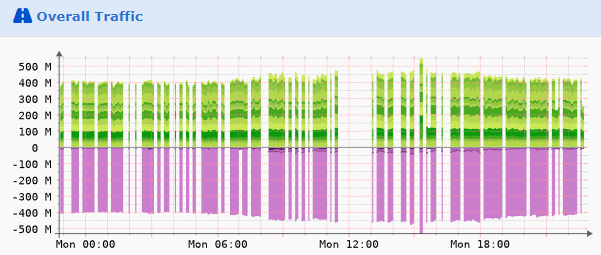

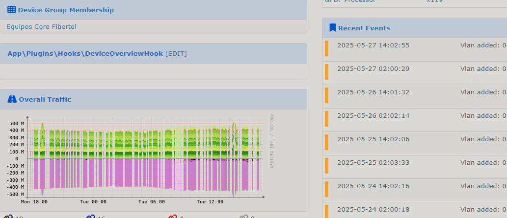

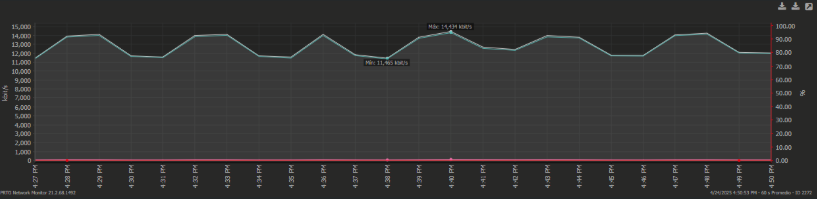

Good day, I’m currently having issues with graph sensing on some devices. I’m seeing choppy graphs on the graph even though I have good connectivity to the device and there are no alarm logs.
Trying with another tool like PRTG, the graph is consistent and doesn’t show any choppy displays like in LibreNMS.
Please help me find a solution for this case using the LibreNMS version 23.4.1.

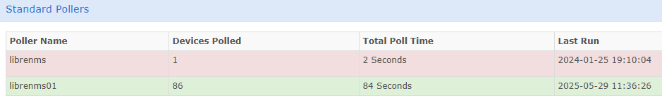

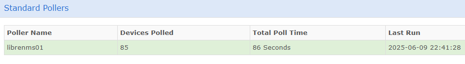

about the polling, I have this:
You have a lot of errors there, and two pollers which doesn’t look setup correctly.
Personally i would suggest doing a snapshot and working on upgrading your LibreNMS install and components along with fixing those errors in validation.

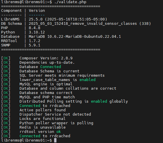

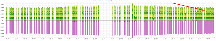

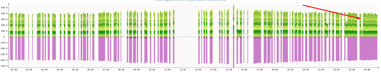

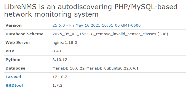

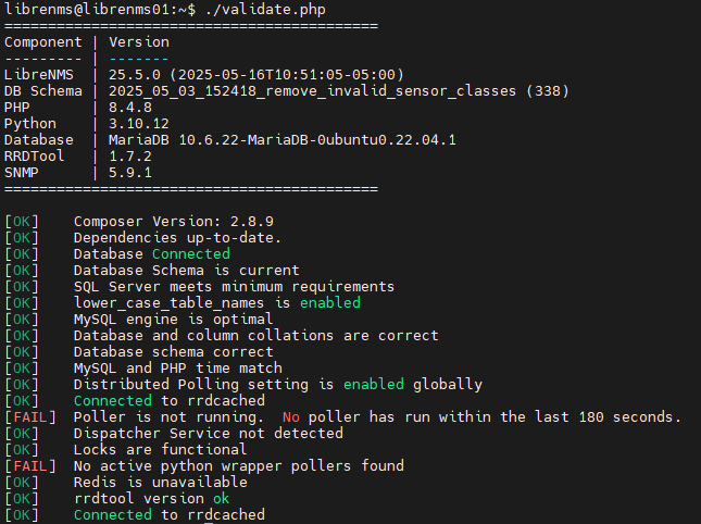

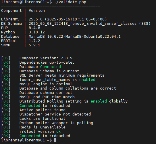

Hi again, in this oportunity I update the server to the last version and delete all errors with the old poller.
However, the problem of choppy graphs still persists.
I’ve noticed that the poller randomly errors out.
How can this problem be resolved? Thank you very much in advance.

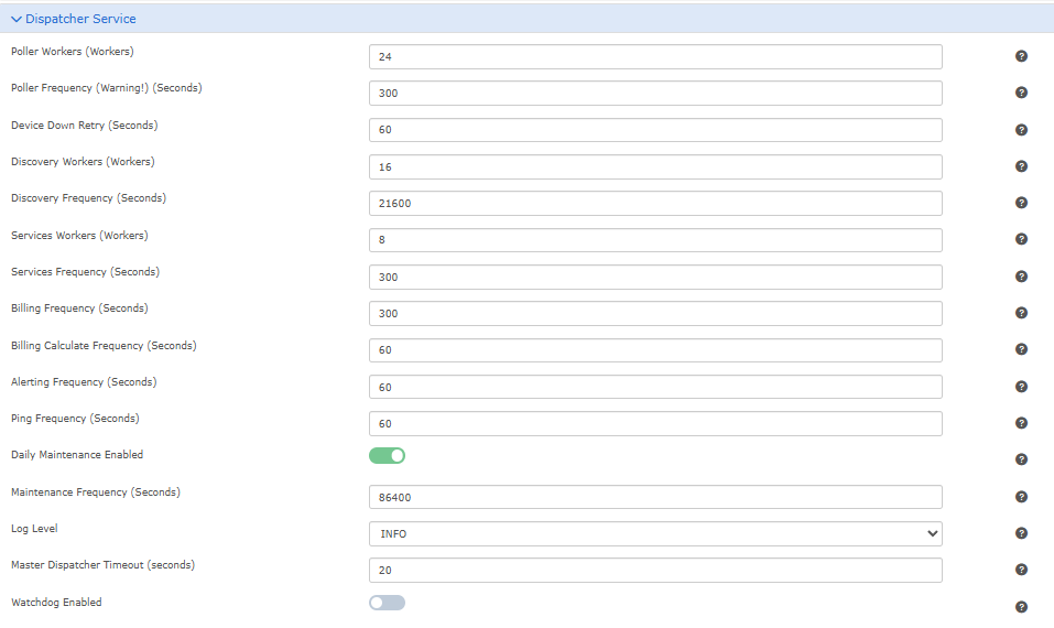

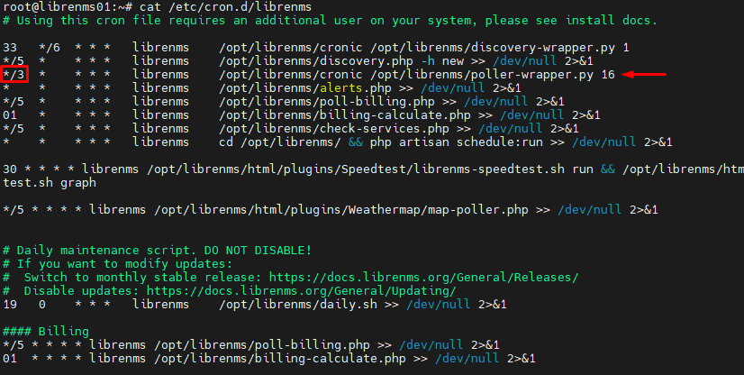

Last time i had those issues i had my poller times shorter than it was taking to poll my list of devices, but i dont know if that will be your issue. Can you check the Settings > Poller > Dispatcher Service and take a picture of the list of items in there?
Here is my config about the Dispatcher Service

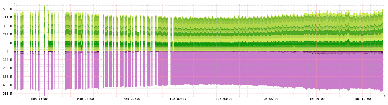

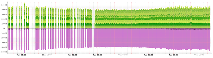

I made a change in /etc/cron.d/librenms that it was in 5 minutes so I reduced it to 3 minutes
After making this change, I’m seeing the graph without interruptions. I’ll let you know in the next few hours if the problem persists.

Currently I have not observed any more cuts in the graph after updating it and making the last modification.

That is not a good fix. Polling interval should match rrd heartbeat. (now if you changed rrd heartbeat, that was the real issue)
For rrd if you try to save data faster in an interval than the heartbeat, the data is discarded so you have wasted a lot of processing if that is the case.
