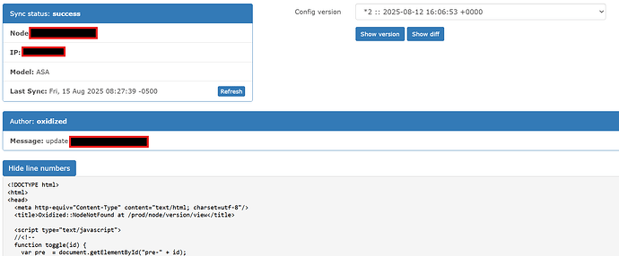

Hey y’all!
Fairly new to both Oxidized and LibreNMS.
Oxidized is running on a separate server and is running just fine.
LibreNMS is on a different server and is running just fine.
Oxidized integration is mostly running fine, but I’m unable to see the configurations.
I get the sync information, the different version information, and the author information. In the are where the configuration is supposed to be is raw HTML.
The biggest piece of information in the code is :
Oxidized::NodeNotFound at /prod/node/version/view
unable to find ‘XXX.XXX.XXX.XXX’
(I did take out the HTML so that it wouldn’t interfere with the post.)
Odd thing is that LibreNME is connecting to the node, and Oxidized is connecting to the node.
Any ideas? Thanks!

As I mentioned, LibreNMS and Oxidized are mostly talking. I’m getting versioning information, node information, backup status, but not the actual backed up config. See the below graphic:
As you can see, I’m getting raw HTML where the config should be.
Would you (or anyone else) have any further ideas?

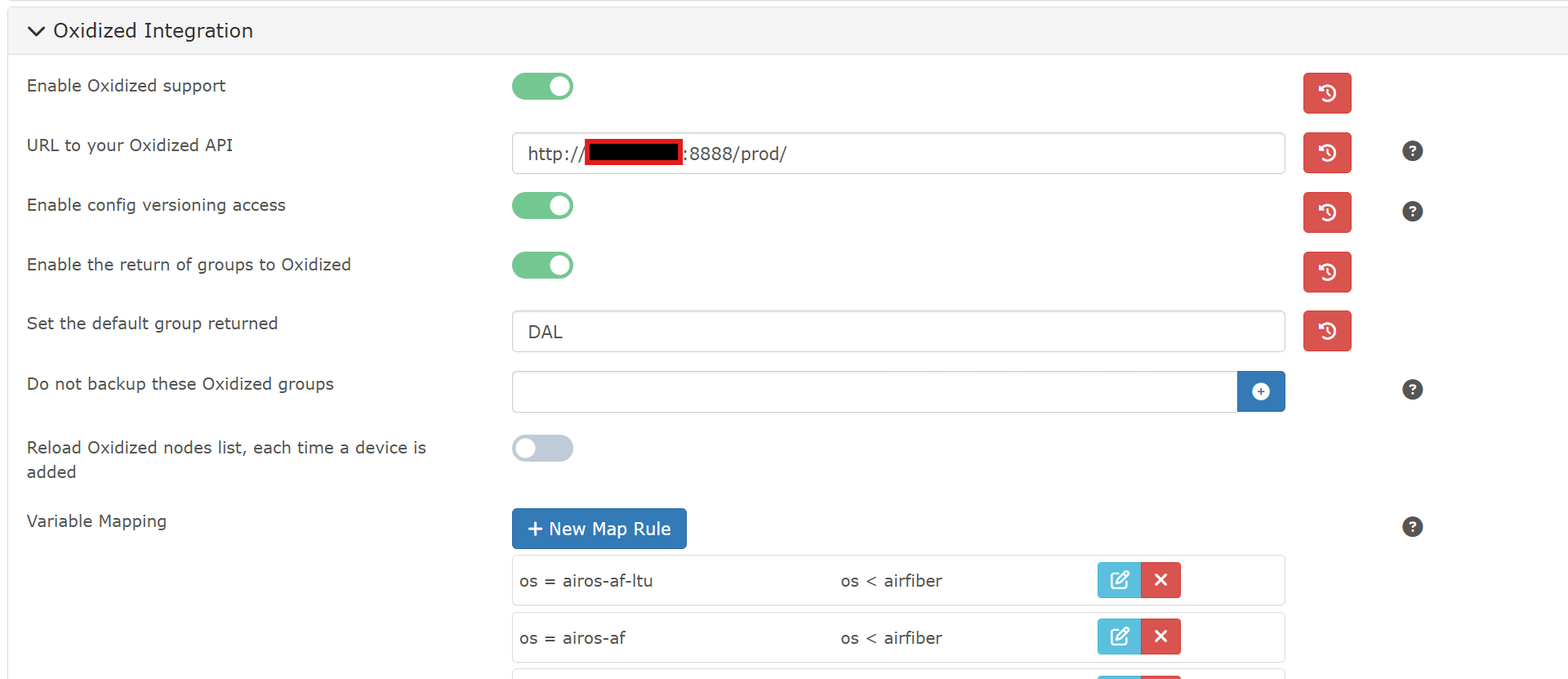

Probably the wrong oxidized url, what does it look like?
http://XXX.XXX.XXX.XXX:8888/prod/
which is what I have in the LibreNMS config:
/prod/ I’ve never seen an Oxidized url with that slug.
It’s configurable in the config file…
Neat, you are first one I’ve seen use that. You should make sure there are no bugs with using that and integrating with LibreNMS. Check all urls LibreNMS is using.
