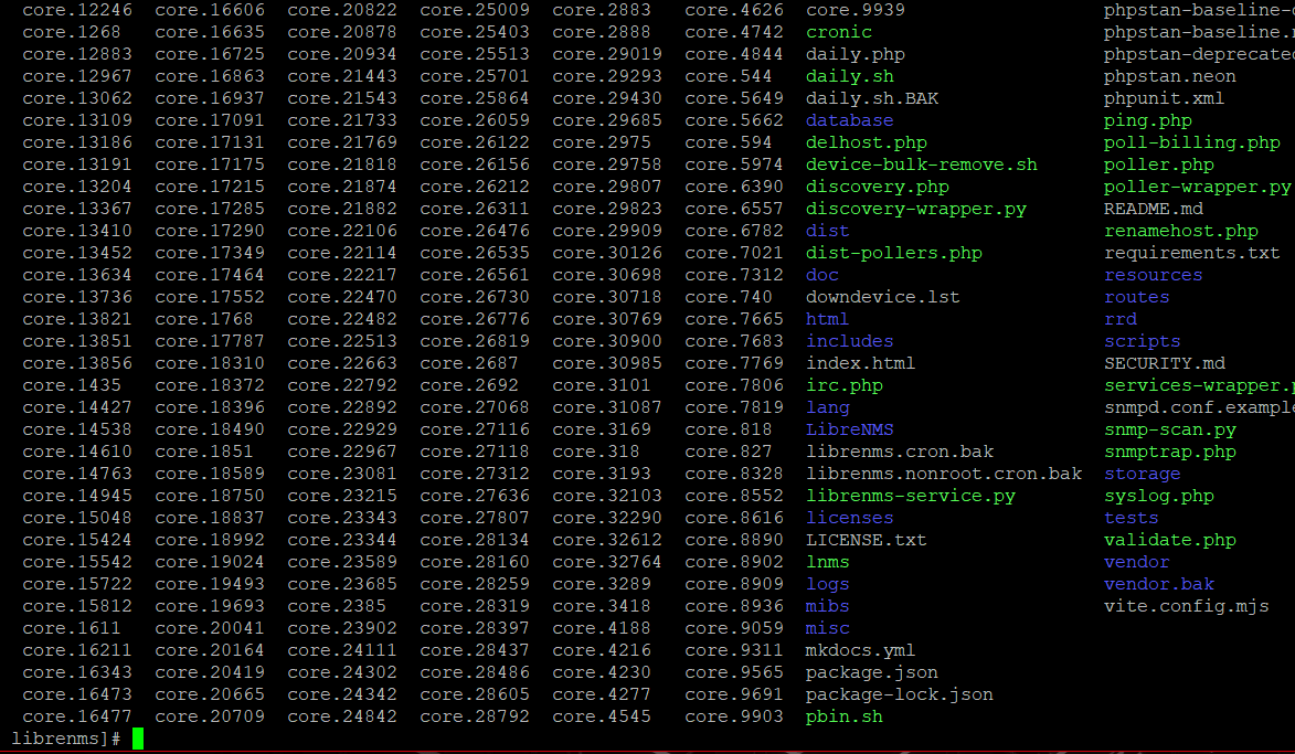

Core files constantly being generated and filling partition
Hello, the application is constantly generating core files and I have no idea why or how to address it. The files are filling up the partition every 2 days and running me out of space. This seems to have occurred after the last update. Any guidance would be greatly appreciated. Server is running RHEL7.9; I’m also experiencing a composer issue with PHP which I’ve posted in a separate thread.

[root@xxxxx librenms]# more core.10002
******** core.10002: Not a text file ********

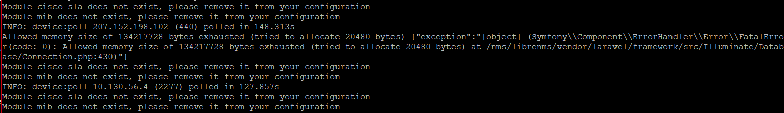

Look in logs/librenms.log at the time the file core.10103 was created for the discovery line to see if anything is logged.
this is what is shown in the logs during one of the core files that were generated. I disabled the cisco sla module in my config but i am not seeing a mib module in my config.

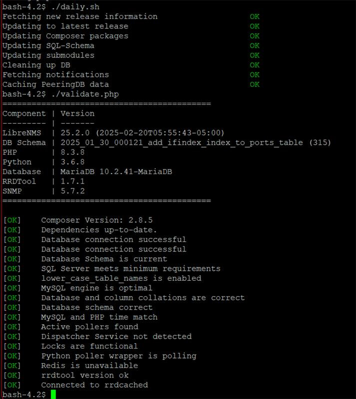

Does:
lnms config:get poller_modules.mib
or
lnms config:get discovery_modules.mib
Show anything?
1st command returns ‘true’; 2nd command returned nothing.
bash-4.2$ lnms config:get poller_modules.mib
true
bash-4.2$ lnms config:get discovery_modules.mib
bash-4.2$

@everyone, I’m still getting these frustrating, huge core files which fill up the partition every 3-4 days. When I view the logs, I’m seeing the errors about cisco-sla being configured but I do not see that in my config file
