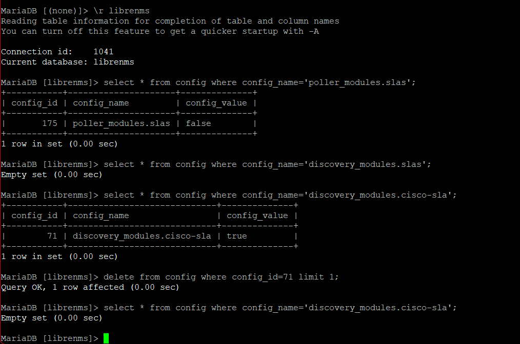

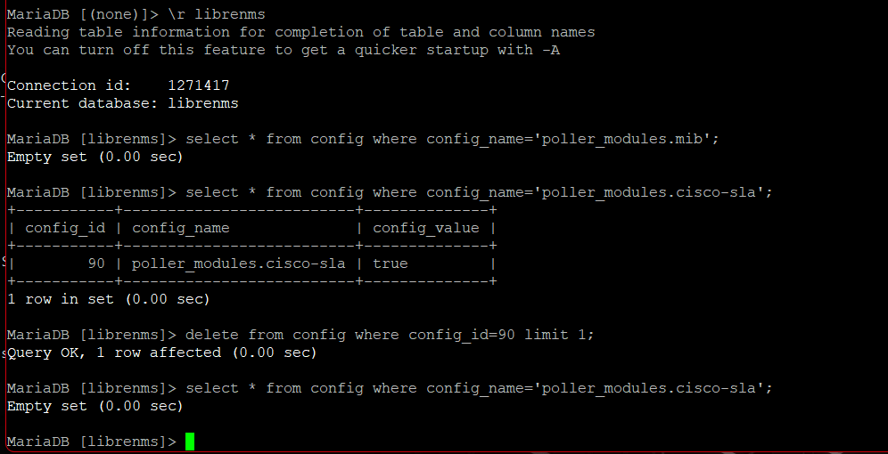

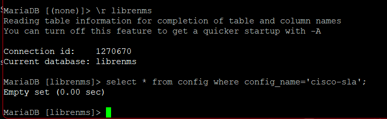

I ran the command with correct syntax and deleted from the database; i’ll monitor and see if the errors and core files stop generating
Errors were still generating; ran database command again using discovery_modules.cisco-sla instead of poller_modules.cisco-sla; and showed enabled in the database; I deleted and will monitor

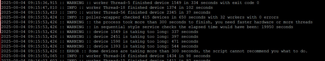

so core files are still generating after removing cisco-sla from database. I look at the time of the last core file which was 12:57 pm today and did a grep on the librenms.log file for that time and getting YamlDiscovery warnings as shown in the screenshot:

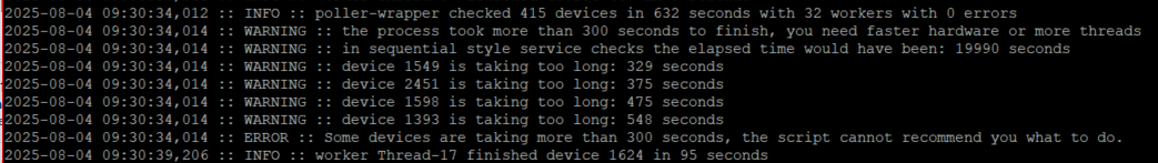

one of the core files generated at 9:15 and 9:30 this morning; when i search librenms.log, there are no warnings or errors. When I search poller_wrapper.log for those times I see these warnings:
discovery-wrapper.log shows these errors:

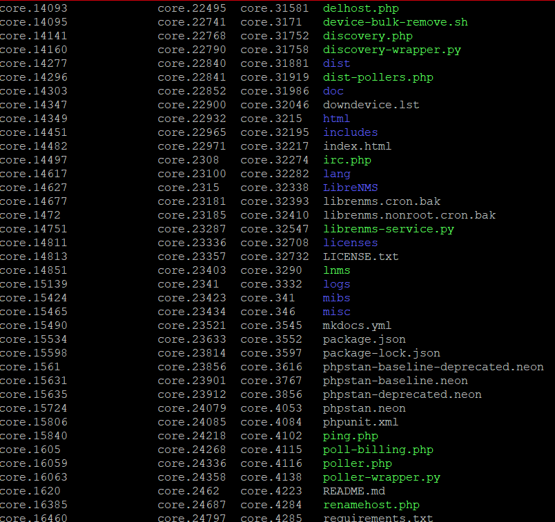

here’s an example of the files…fills the filesystem about every 3 days and getting frustrating as I don’t know how to prevent this. I have to login and do an rm -rf core.* to get the space back.

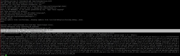

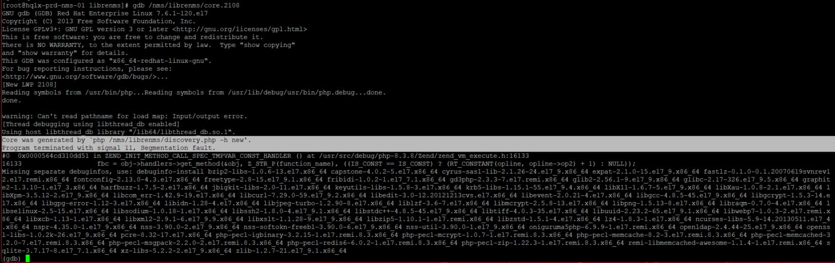

So I found a command to read the core files @laf @murrant @rhinoau
gdb ‘/path/to/executable /path/to/core’
after running it against several of the files, it appears to be an issue with discovery.php -h new …see screenshot. Hopefully someone can chime in and provide more guidance now that I’ve found the cause of the core dump files

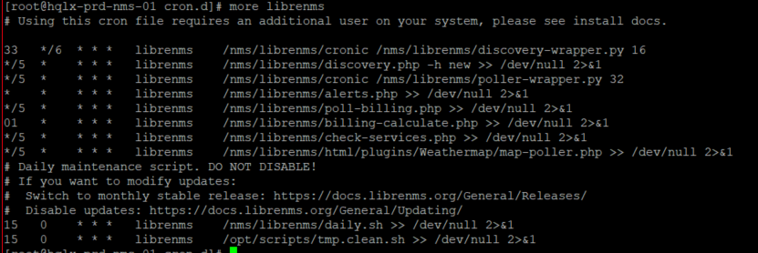

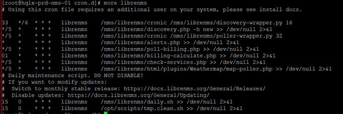

Also, i found that the crontab is referencing the discovery.php -h new command (the command that is generating the core dumps); could this be the issue?
I mean discovery.php -h new is run on 1000s of installs perfectly fine.
If it was me, I’d remove all traces of php and re-install it. Ensuring you remove config files and see if that helps.
This is PHP itself crashing. You have an issue with the installed version of PHP on your system. Nothing LibreNMS can do can fix that. You’ll need to update or repair your PHP.
