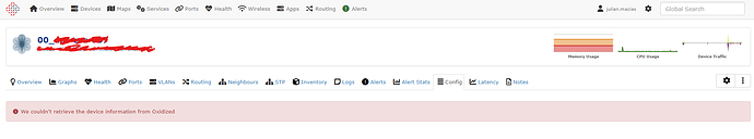

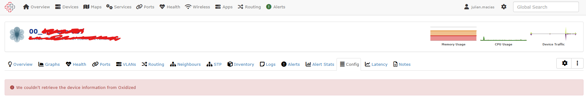

Crash oxidized after upgrade to Debian 12
My installation was working fine until I had to upgrade from Debian11 to Debian12 due to client security restrictions.
Attached are the configuration files:

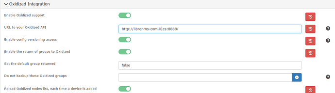

  • Config Oxidized in LibreNMS:

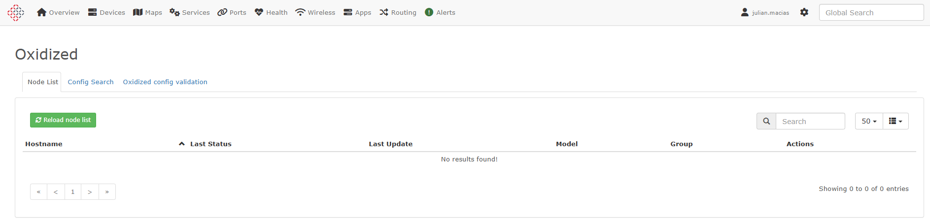

  • The service is running and extracting configurations:
root@librenms-com:~# systemctl status oxidized.service
● oxidized.service - Oxidized - Network Device Configuration Backup Tool
     Loaded: loaded (/etc/systemd/system/oxidized.service; enabled; preset: enabled)
     Active: active (running) since Mon 2025-05-26 12:13:30 CEST; 1h 13min ago
   Main PID: 1277 (oxidized)
      Tasks: 8 (limit: 77079)
     Memory: 155.6M
        CPU: 2min 18.440s
     CGroup: /system.slice/oxidized.service
             └─1277 "puma 6.6.0 (tcp://librenms-com.X.es:8888) [/]"
may 26 13:26:49 librenms-com oxidized[1277]: lib/oxidized/worker.rb: 1 jobs running in parallel
may 26 13:26:50 librenms-com oxidized[1277]: lib/oxidized/worker.rb: 1 jobs running in parallel
may 26 13:26:51 librenms-com oxidized[1277]: lib/oxidized/worker.rb: 1 jobs running in parallel
may 26 13:26:52 librenms-com oxidized[1277]: lib/oxidized/worker.rb: 1 jobs running in parallel
may 26 13:26:53 librenms-com oxidized[1277]: lib/oxidized/worker.rb: 1 jobs running in parallel
may 26 13:26:54 librenms-com oxidized[1277]: lib/oxidized/worker.rb: 1 jobs running in parallel
may 26 13:26:55 librenms-com oxidized[1277]: lib/oxidized/worker.rb: 1 jobs running in parallel
may 26 13:26:56 librenms-com oxidized[1277]: lib/oxidized/worker.rb: 1 jobs running in parallel
may 26 13:26:57 librenms-com oxidized[1277]: lib/oxidized/worker.rb: 1 jobs running in parallel
may 26 13:26:58 librenms-com oxidized[1277]: lib/oxidized/worker.rb: 1 jobs running in parallel

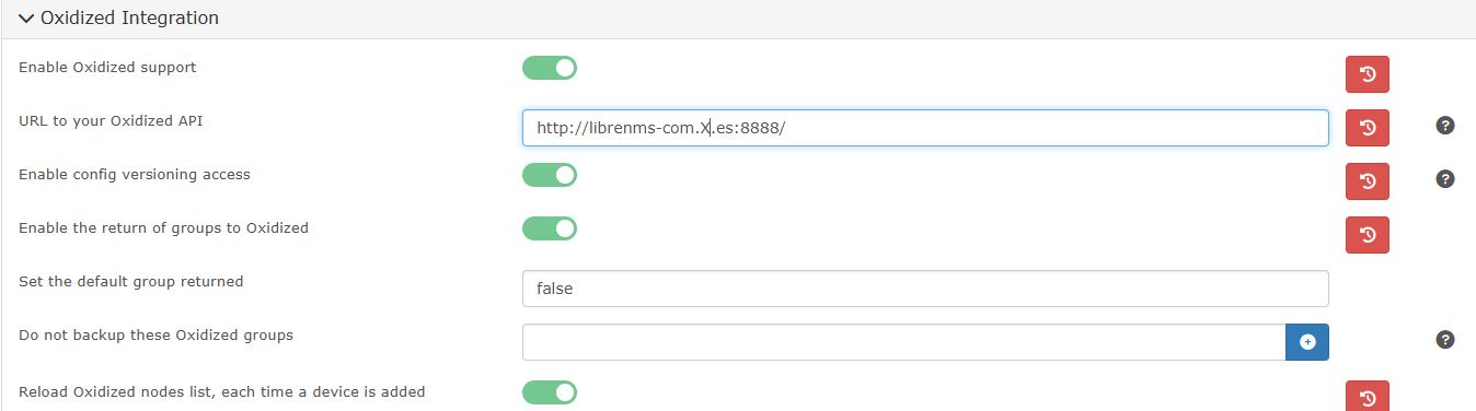

  • But if I do a curl there seems to be a problem with the certificates or the handshake::
root@librenms-com:~# curl -v -f https://librenms-com.X.es:8888
*   Trying 172.X.X.13:8888...
* Connected to librenms-com.X.es (172.X.X.13) port 8888 (#0)
* ALPN: offers h2,http/1.1
* TLSv1.3 (OUT), TLS handshake, Client hello (1):
*  CAfile: /etc/ssl/certs/ca-certificates.crt
*  CApath: /etc/ssl/certs
* OpenSSL/3.0.16: error:0A00010B:SSL routines::wrong version number
* Closing connection 0
curl: (35) OpenSSL/3.0.16: error:0A00010B:SSL routines::wrong version number
If anyone has any ideas and can help, I would greatly appreciate it.

First of all, thank you for your reply. I understand that it is a https/http/certified/encryption problem, but as the error was not occurring before the upgrade, I thought: maybe some package or fix not installed.
This is the output without https:
root@librenms-com:~# curl -v -f http://librenms-com.X.es:8888
> GET / HTTP/1.1
> Host: librenms-com.X.es:8888
> User-Agent: curl/7.88.1
> Accept: */*
< HTTP/1.1 403 Forbidden
< content-type: text/plain
< x-content-type-options: nosniff
< Content-Length: 18
* The requested URL returned error: 403
curl: (22) The requested URL returned error: 403

Weird that you’re getting a 403.
Maybe you’re running into something similar to this thread:
Wow thank you so much.
I added in the line: set :host_authorization, { permitted_hosts: [] } in the file /var/lib/gems/3.1.0/gems/oxidized-web-0.15.1/lib/oxidized/web/web/webapp.rb and it works:
root@librenms-com:/var/lib/gems/3.1.0/gems/oxidized-web-0.15.1/lib/oxidized/web# curl -v -f http://librenms-com.X.es:8888
*   Trying 172.29.128.13:8888...
> GET / HTTP/1.1
> Accept: */*
< HTTP/1.1 302 Found
< location: http://librenms-com.X.es:8888/nodes
< content-type: text/html;charset=utf-8
< x-xss-protection: 1; mode=block
< x-frame-options: SAMEORIGIN
< Content-Length: 0
* Connection #0 to host librenms-com.X.es left intact
and is now available on LibreNMS.
