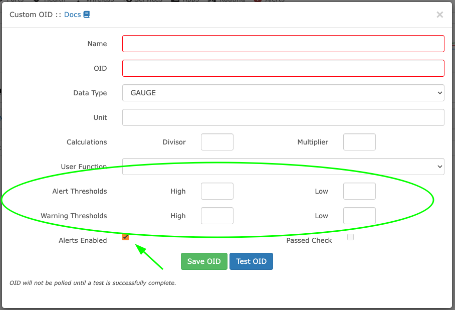

You should be able to. When you setup the customoid there are thresholds for alerts and warning level and a checkbox to enable alerts for that OID.

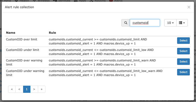

On their own, those don’t do anything, but if you set those then you can just use the customoid alert templates (Alerts > Alert Rules > Create rule from collection).
If you add those they should just alert when they hit the threshold vaules. Alternatively, you could use one of those but instead of the customoid_limit variables just use a static value.
