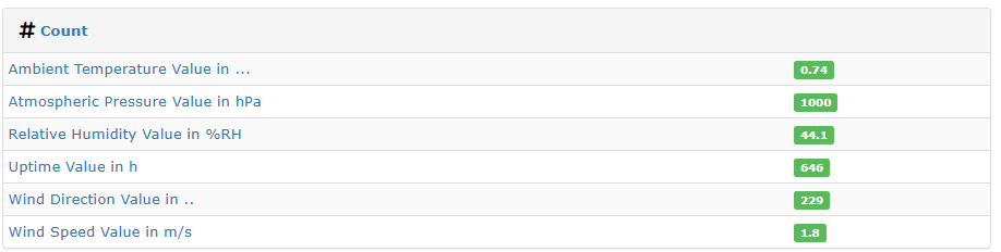

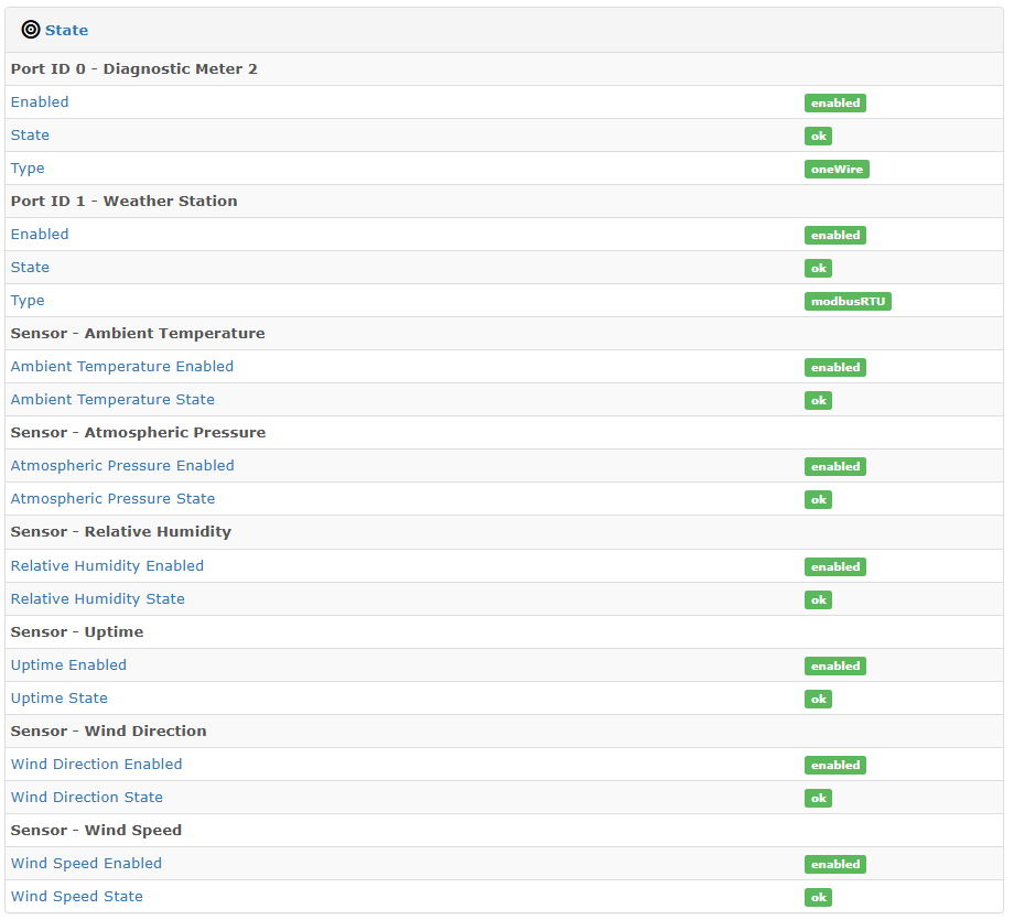

Hi, thanks for the help!
It seems to be working fine!
It detects the correct OS and adds the Modbus RTU interface that we use to communicate with an anemometer.
The anemometer has a total of five meters that we use.
I have created a new snmpwalk that contains more information than the old one, if that is of any help.
https://p.libren.ms/view/a35900a0
BR Matte Nilsson

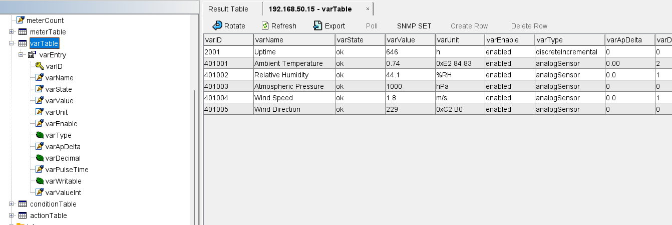

cool.
just an FYI , there is a VARtable that has the data from the sensors.
A smarter person might be able to incorporate the data into Librenms.
@Matte_Nilsson
Would this be of any value?
The sensor values are as a simple count.

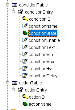

Also,
If its not to much trouble, could you make a couple conditions and actions.
I want to see how it populates the tables.
