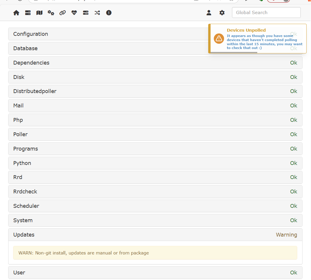

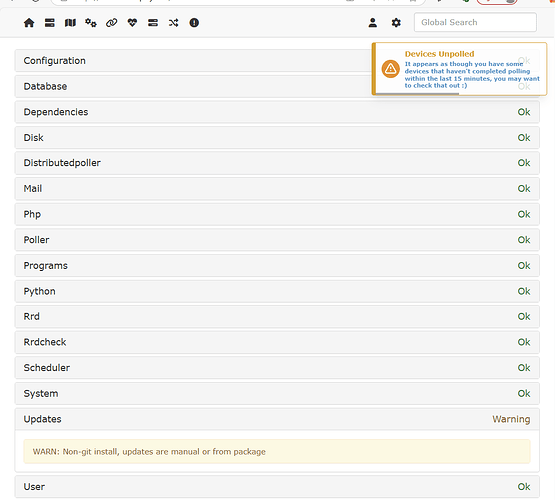

Device UnPolled. i cannot find any errors help me

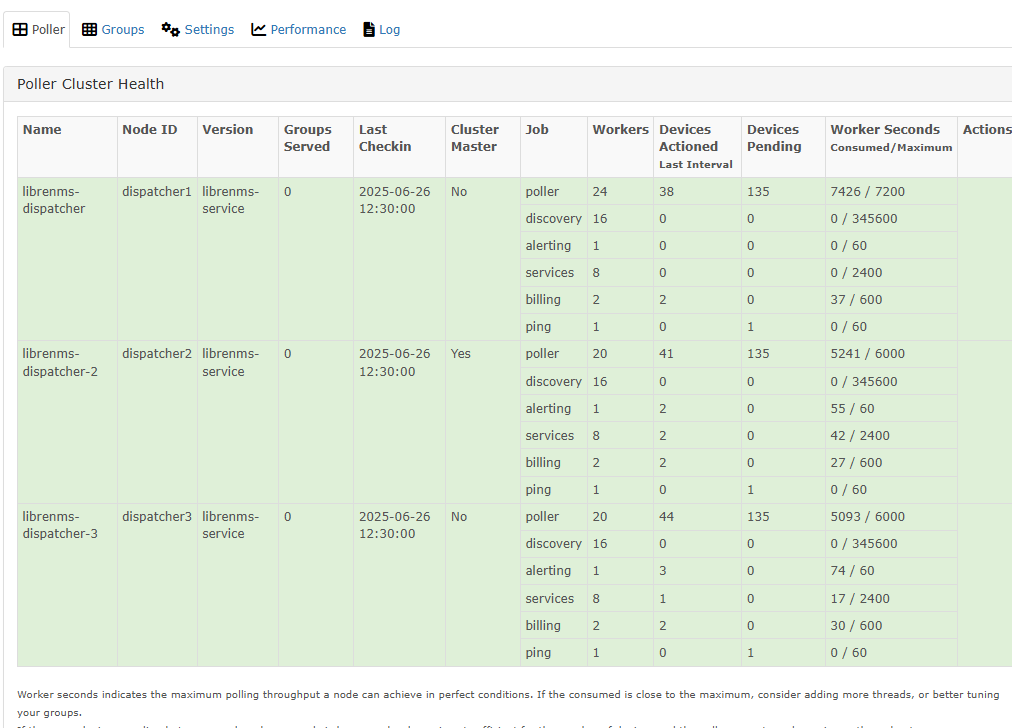

Hi guys! please help me some of my graphs are broken and im seeing these everytime i logged in. that i have devices unpolled.

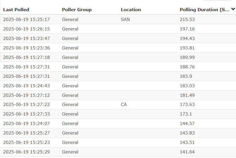

i have devices that have these that the polling duration is 200 seconds. how can i fix this. or how to debug it. im using docker on it
I think this means that your polling is taking too long and not completing in the the 5-minute time slot. That is a lot of long device poll times. You should look at reducing that time.

I tried making 2 more pollers and i dont have broken graph and all are polling but my cpu spikes up
I tried making more 2 pollers, no broken graphs and no device unpolled but cpu spikes up

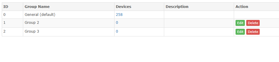

i setup a 2 new poller since monday from monday to wednesday this poller is great then comes today the devices are polling slow again, how can i make it the device to have like per poller group. i create 3 groups now
how can i assign each device to this group . I cannot saw a setting when i click the device to assign to a designated polling group
I suggest setting all pollers and devices to group 0. Pinning devices to a poller is bad practice.

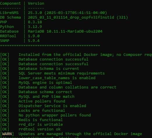

this is my validate.php file. i noticed that python wrapper pollers found is no. ive set my poller workers now to 32 for 3 dispatchers. should i just use 1 dispatcher or deploy 3 dispatcher in a single instance?
