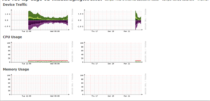

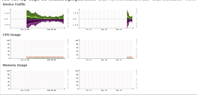

Devices not graphing - delete and re-add the device - starts graphing
Devices are not graphing.
If I delete the device and add the device back, it starts graphing.
However, it’s still not graphing the memory usage.

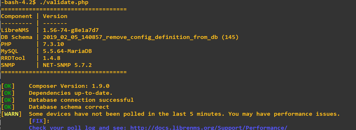

please run ./validate.php
Kevin,
Your poller is not running you need to trouble shoot that i would check the cron.
