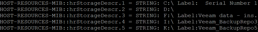

Did you test walking HOST-RESOURCES-MIB::hrStorageTable? I suspect the built-in snmp might not include them.
I do not really know how to do this or what this means.
I just tested and this is seen during the walk:
I: being ISCSI

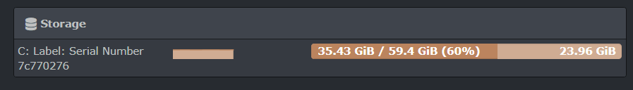

This is seen in LibreNMS webui for the same host:
Possibly filtered by the brain-dead pre-fork filtering defaults :smiley:
