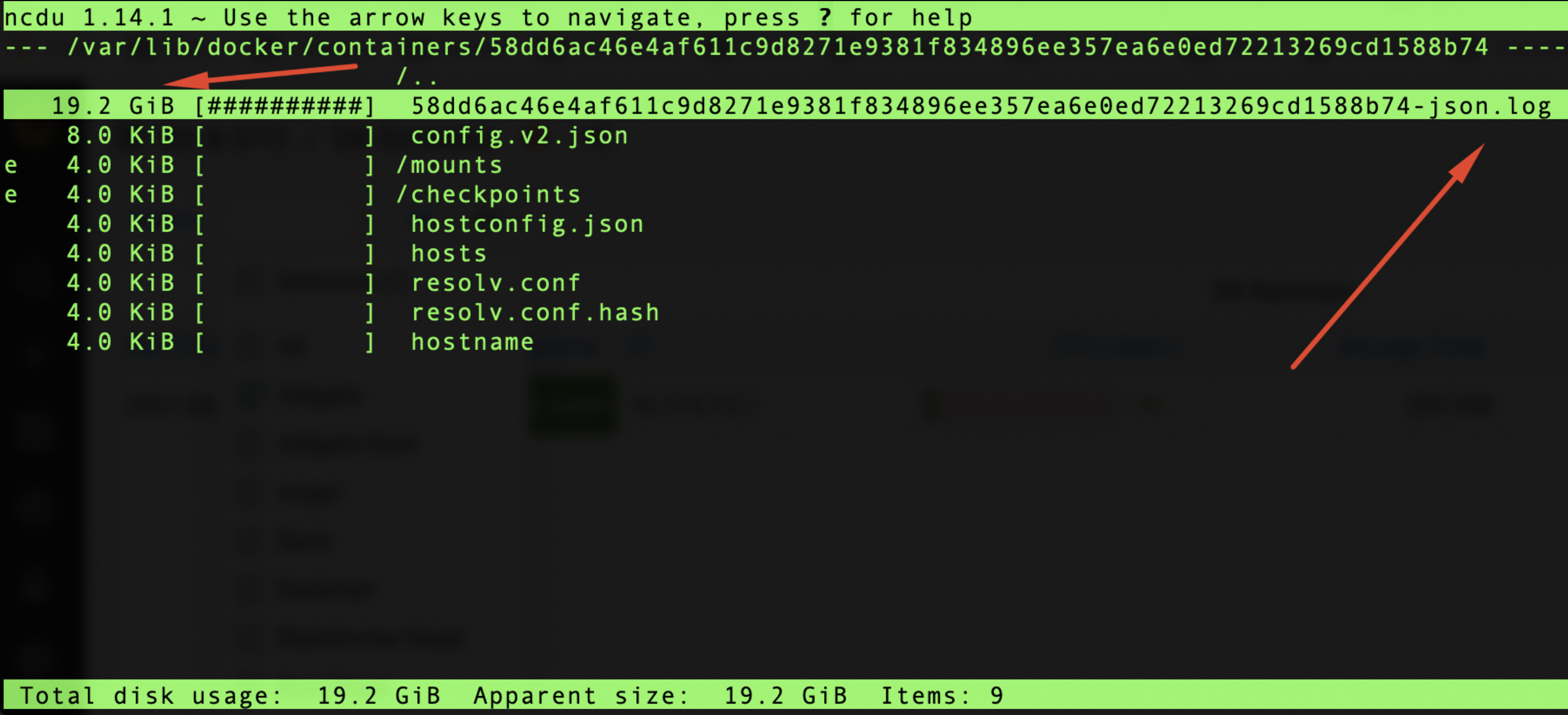

I’m not expert at Docker, but I have seen a container wipe out the space on a VM today.
When I looked it was this json.log file with the container for InfluxDB, the DB is for LibreNMS as I use LibreNMS in Grafana via Influx.
I had to stop the container then remove it and start it up again to get 20GB back.
What steps can I take to help with this growing as we don’t need this much log data.
This is the docker compose file, starts at line 19.
