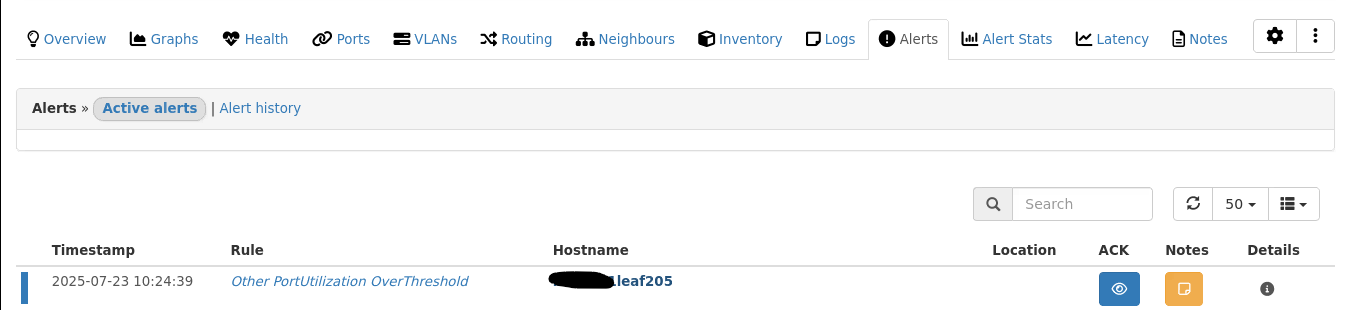

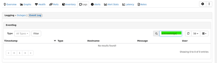

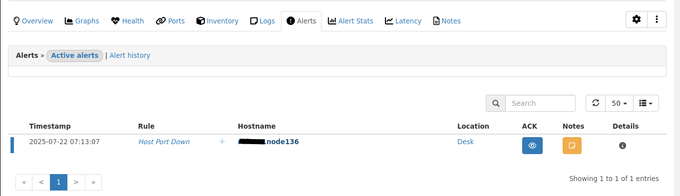

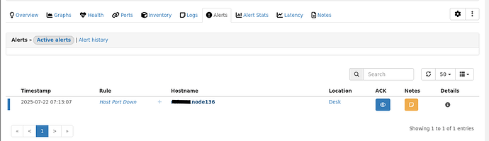

API Ack using Curl::
On Event Logs, there is no information of acknowledgment

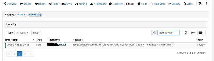

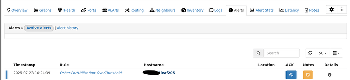

Ack from UI::
On Event Logs, there is a entry of acknowledgement
